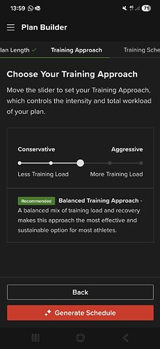

Did you change the slider approach…I.e. from balanced to aggressive? That would ramp up somewhat, as would using the ‘check plan volume’ option more often to see if it will allow more capacity. However, the TR argument will be that the balanced approach is the best one for you and if you did more you may end up too fatigued. If you want to stay with TR building your plans next year I would maybe look at playing with the slider and really listening to your body. If you find you can handle an aggressive load then that may well give you better results.

I did adjust things like turning “off” the Masters option, moving the slider to “Advanced” and leaving my FTP at my original 245 vs the TR suggested 232. Number of weekly training hours was between 6.5 - 8. Not unreasonable and had no issues with being over tired.
