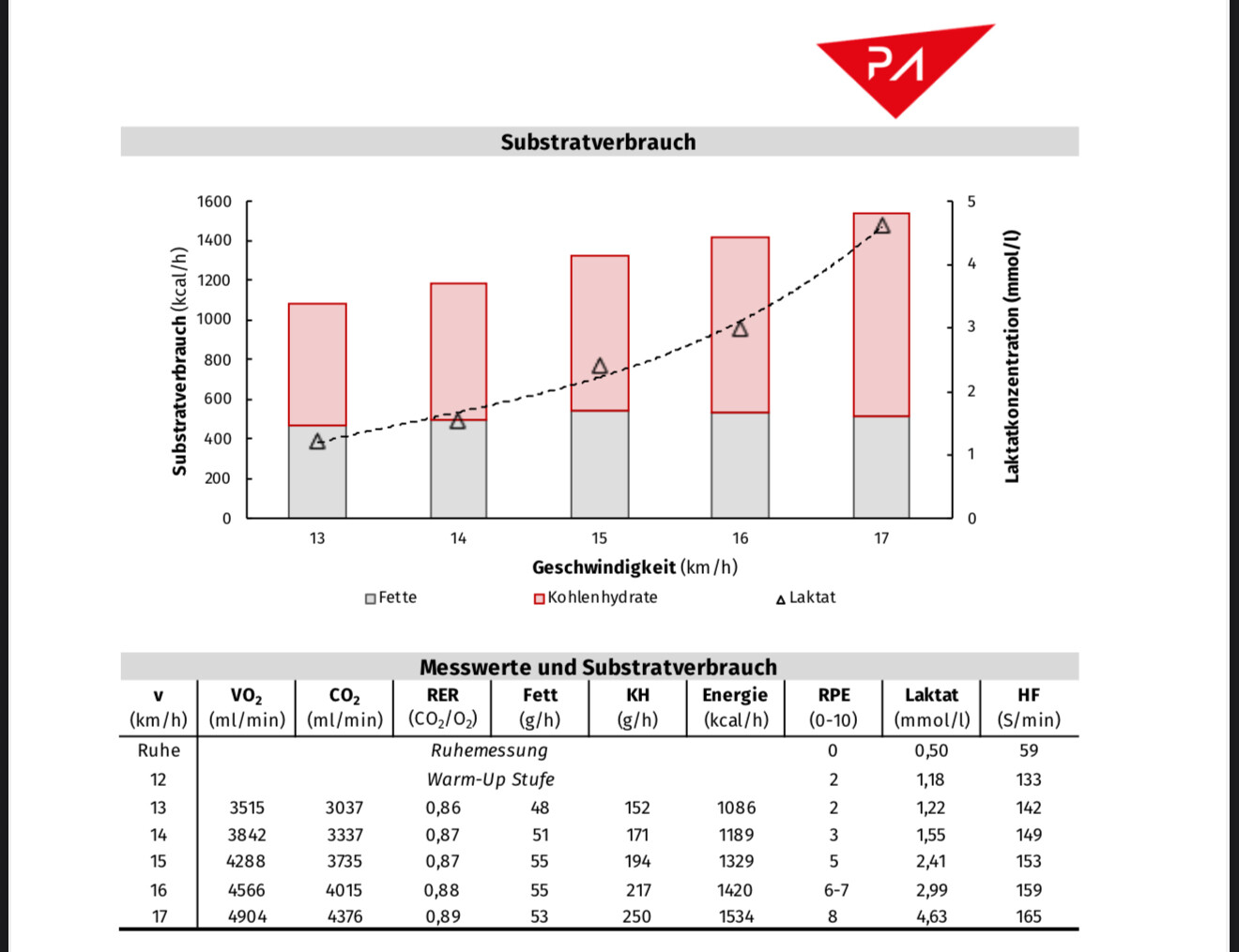

  • Threshold pace: From 3:45 → 3:40 min/km
  • VO₂max: From 69.7 → 73.3 ml/kg/min
  • I made it one step further. Last time I collapsed on 3:00 pace at 1% grade, now same pace at 2% grade.
  • FatMax: Still at ~4:15 min/km, but now fat oxidation remains active even at 16–17 km/h (3:45 to 3:31 pace)
  • Lactate response: Still very low — I hit 2.99 mmol at 16 km/h and just over 4 mmol at 17 km/h
  • Energy use @ 15 km/h: 1,329 kcal/h (so still inefficient… but improving)
  • Fat burn @ 15 km/h: ~55 g/hour, which is really solid. Huge carb-sparing benefit.
