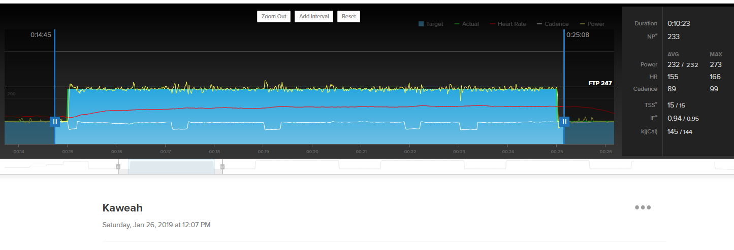

  • Here is a snap from a recent steady-state workout, Kaweah that I did last week.
  • Notice the very steady cadence (other than the slow cadence, standing breaks) and how much variation is shown in the power graph.
  • It has the same basic power variation (breaks/boosts) bouncing that can be seen from a rider in Resistance mode and controlling the power more directly via their cadence (and related gearing).
  • This was performed on a Kickr 17,
    • ERG mode,
    • Latest firmware,
    • No smoothing on ERG mode (Wahoo setting),
    • 34t x 17t (middle of 11-28)
  • There is variability in EVERYTHING. Even in Tom’s precious Resistance will vary. And his point of narrowing that range makes sense.
    • But that type of performance can be honed on ERG by learning to steady your cadence and make sure you have a clean and efficient pedal stroke.
    • Resistance mode is a way to do it, but sure as hell not the only one.
  • So much of the confusion seems to come from a lack of full understanding and proper use of ERG mode for accurate comparison.
  • People incorrectly assume that ERG means perfection, and it does not. It is a tool that allows some great use and different advantages than Resistance. But it’s not magic either.
  • My overall point is that neither option is completely superior. There are pros and cons, and people should likely use a mix, if they can.

You beat me to posting a graphic… but here is my “locked in” ERG mode.
Cadence in first interval was pretty steady, second interval had a little more variation, I think these were standing drills. But regardless, it still takes concentration to hold the wattage at my desired cadence. I find ERG more of a “suggestion” rather than an absolute. You go above, things get a little easier, go you below and they get a little (or a lot) harder, but there is nothing keeping you at an exact wattage.
