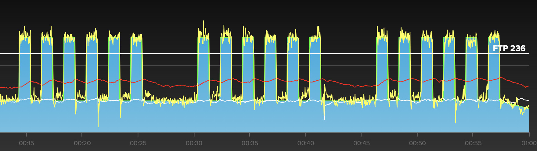

Per your workout, here is a clip of the last set:
  • Notice that you show a clear and steady ramp up in your cadence. Based upon your comments, it seems you were “speeding up” your cadence to “fix” the dropping power you saw and interpreted as a problem (at least that is my take on the evidence shown).

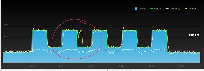

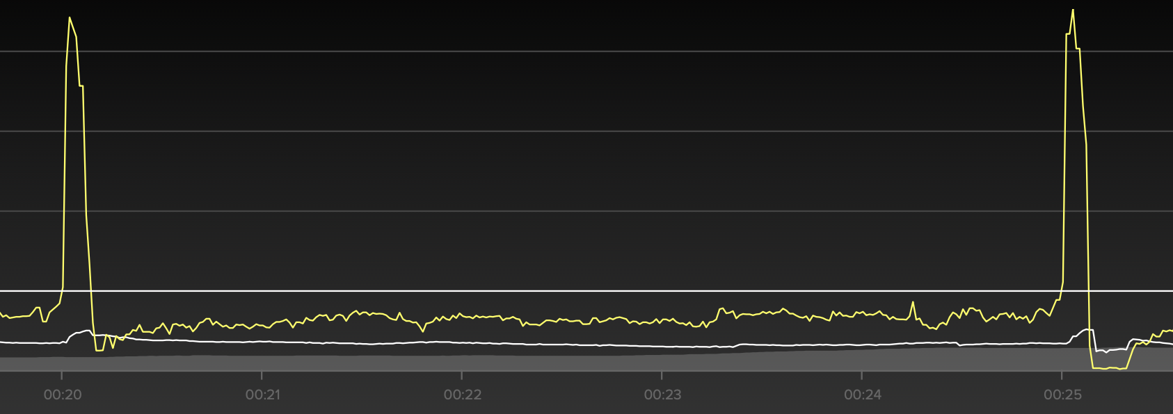

Edit to add, here is my workout done on a Wahoo Kickr 17, in ERG with power from the Kickr (ERG mode smoothing off).
  • Note that my cadence is “flat” and even with that, the power fluctuates. This is NORMAL and to be expected. Again, “perfect power in ERG” is a myth that needs to die.

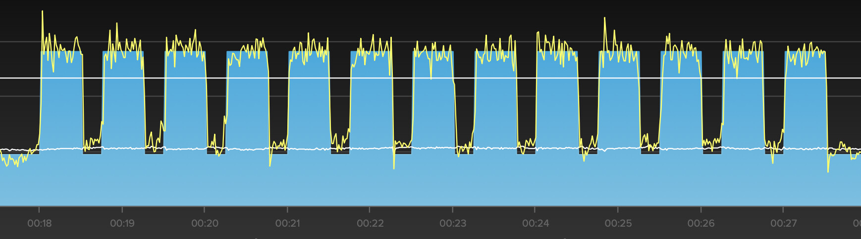

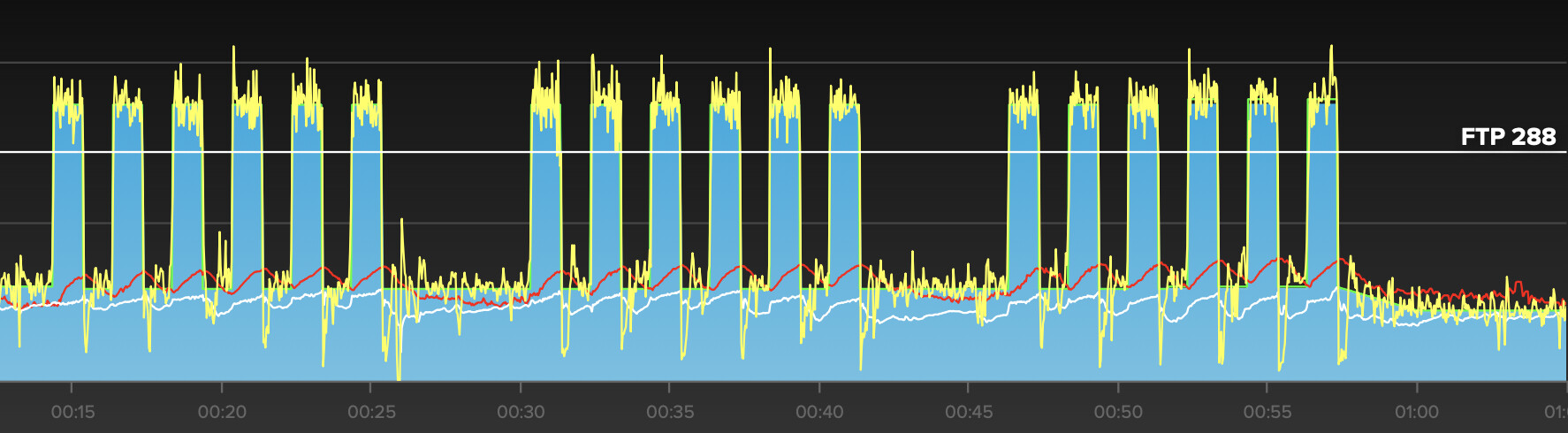

Yours on Saris H3:

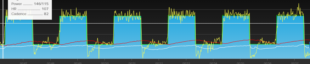

One of mine on Kickr 2017 direct drive with PowerMatch and left-only Stages PM
You can see I was putting down a little too much power at the start of most intervals.

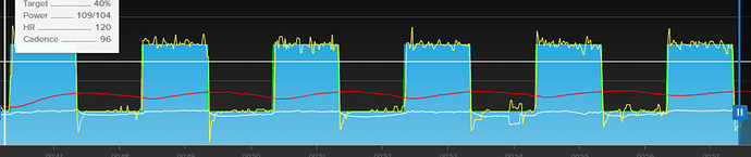

and another one with dual sided Stages PM, a couple months later and with better muscle control:
Yours look normal and fine to me. Possibly smoother than you could do outside.

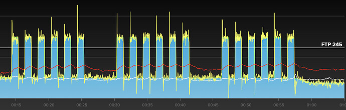

I train almost exclusively in ERG mode - Using a Kickr Core - My power is almost exact but i do have it on 3 sec smoothing. My workout looks like this.
One problem i experience is when i come off an interval into a rest interval the trainer tends to overspin with the sudden drop in power - its like peddling in air, no tension on the trainer - TR app thinks i’ve stopped and the program pauses, once the flywheel has slowed down and resistance returns to the peddle the program starts again.
