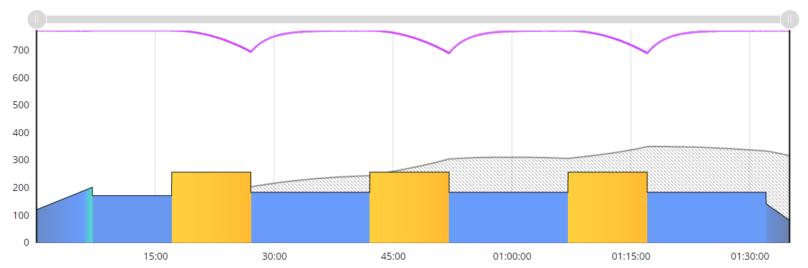

If its to work threshold, then use a 10:1 or 10:2 work:rest interval and make sure you rest at about 50% FTP. Don’t complicate it. Its all about getting as much time at, or very close to, threshold - 40-60 mins is a good goal.
If you want to do work at LT1 then you need to ride for a LOT longer than15 mins to see any benefit - do it as a serperate session. Long z2 ride with loads of time at LT1 for example, or do a long trainer ride around LT1 for 60-120 mins etc.
Unfortunately, this workout is indoor. I’d like to mimic what I’d do outdoor. To make it a bit more realistic also to race conditions.
At the moment I don’t know my threshold well. If the first interval feels too hard, I have no problem turning it down. I’m estimating it by a 10 minute interval I did by feel (outside), without looking at the head unit. It just felt right, and HR was confirming.
  • Get 30 minutes of threshold +
  • Given that I hate the trainer, minimize the pain +
  • I’m increasing my volume, I don’t want it to be too hard for the next day +
  • I want to get 1h30m of training time.
Threshold scattered during the ride is my goto saturday workout. I like 2:30-3h ride with 1 effort in every hour or every 20-30min. Z2 between the efforts. It’s a good workout, as you keep progress it properly- so add time every ride. Also try variations- two efforts, long z2 and 2 effors or vary the lenght of the threshold intervals (for example 15, 10, 15, 20). Those are very entertaining rides and I prefer them to the typical threshold workouts like 3x20 or 4x15.
According to KM you get all the benefits of threshold as important part is TiZ.
Begs the question about what is planned for the next day…
There’s nothing wrong with the workout you described in a vacuum, but how it fits with the overall plan, the goal of the session, and your goals might change the answer. For example, if you’re looking for aerobic adaptation you might have a short rest period. If you’re looking for improved fatigue resistance you might stack the intervals later in the ride. If you’re working muscular endurance what you have is probably fine.
