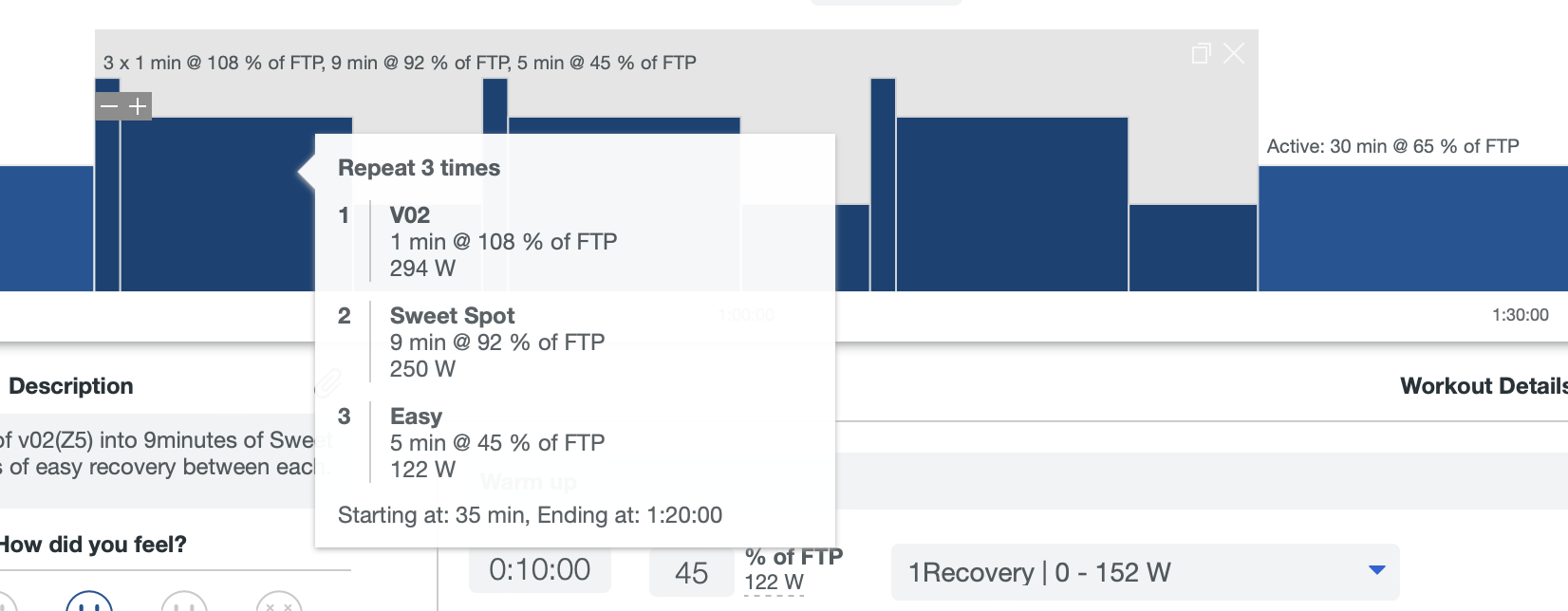

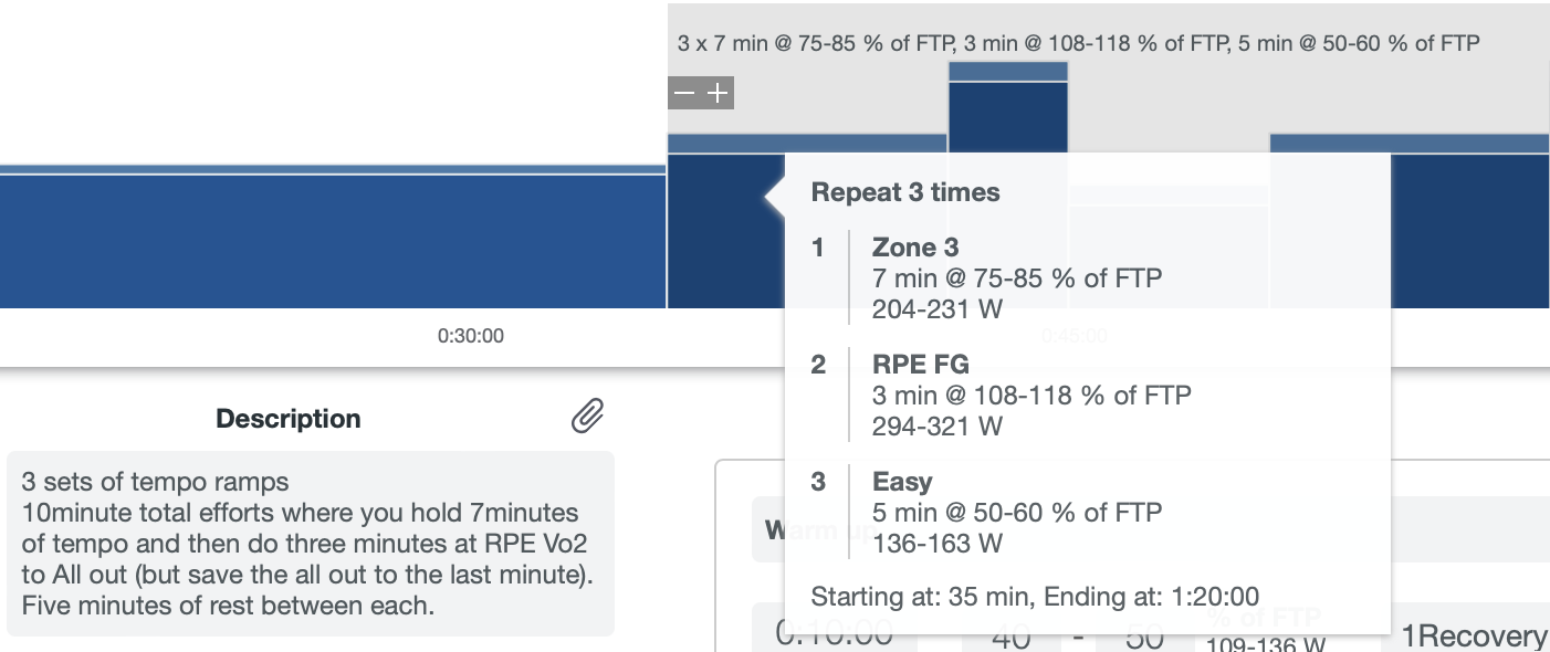

Another variation
where you do 2 minutes RPE vo2 and the last minute is all-out. On the road I usually push the tempo at 85-90%.
All kinds of interesting over/under variations that are not the same as Tom Bells. Those above are from my coach, I’ve got several Cusick plans (two older, a new BaseCamp Road Build to Peak) and don’t recall seeing anything like those in his plans.

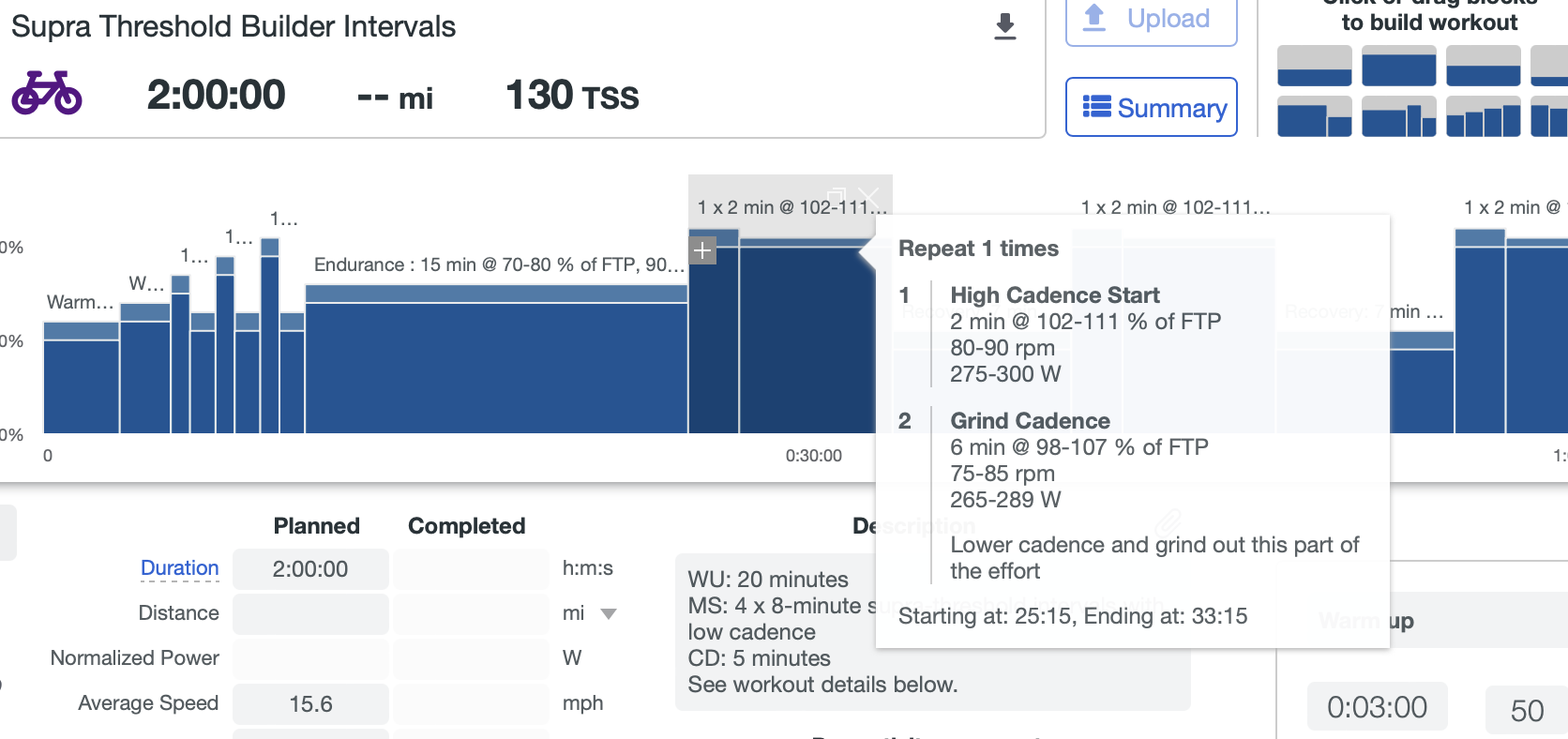

Yes hard starts are nice. As I remember I have seen them in Tim Cusicks library. They are great as race specific workout to give a boost to steady threshold. I have used version with 2min@120% and the 8min@100%. Those are hard!

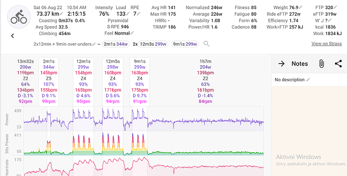

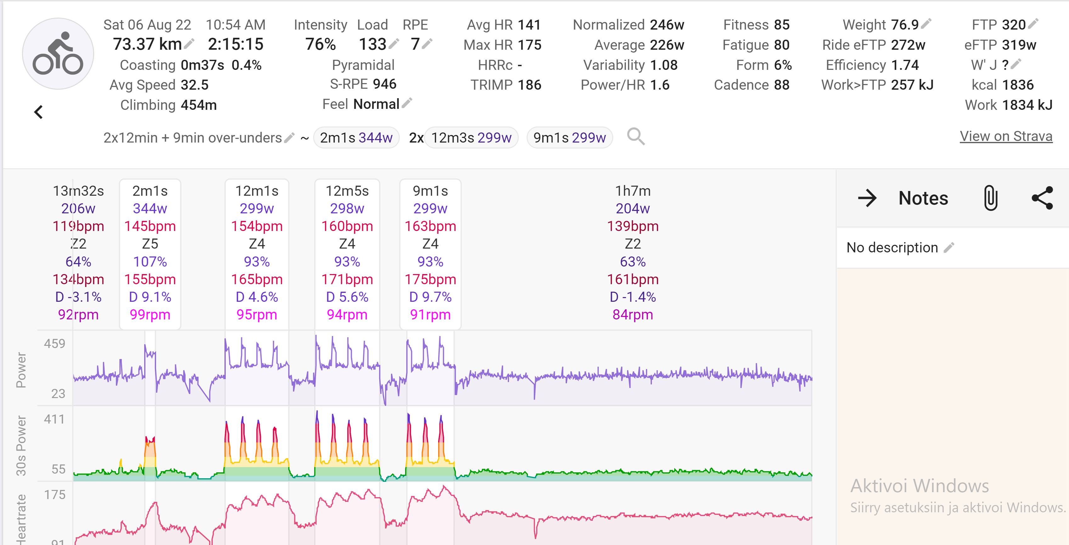

Last winter, I did the following threshold progression after a sweetspot block and VO2 block:
Week 1: 3x10 at 96%, 3x9 OU 2 min at 95%, 1 min at 105%
Week 2: 4x10 at 96%, 3x12 OU 2 min at 90%, 1 min at 110%
Week 3: 5x10 at 96% 4x12 OU 2 min at 95%, 1 min at 105%
Week 4: 6x15 at 88-90-92-94-92-90%
Honestly, I didn’t feel like I got a whole lot of benefit out of this and carried a lot of fatigue. I am bad at threshold riding (cue the “your FTP is too high!” comments). I can do sweetspot for hours and have decent VO2 powers. I’ll probably stick with sweetspot progressions and VO2 blocks instead of threshold. Threshold is, however, great for improving my intestinal fortitude.
