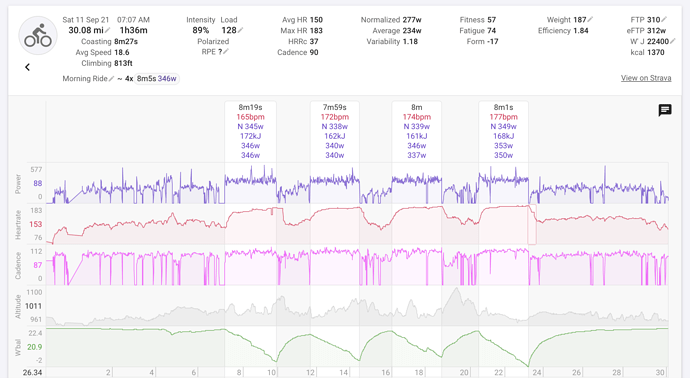

Alright, first 4x8 session in the books. Final workout on week 3 of a loading week. I was curious to see what would happen to my FRC after these intervals and it tanked. That’s good!
Side note: FTP currently @ 310, but given 4x8’s were done @ 346, 340, 346, and 353 has me wondering if it’s time to re-test.

Sorry, a couple of Q’s about this pic for intervals:
  • How do you configure the intervals to show NP oppose to avg watts (or you show all there)
  • Is this outside? Your power is really smooth given the undulating terrain profile
  • Is that bottom graph FRC (or xert MPA)? How did you configure that in intervals for a given ride?
Using intervals.icu, there’s a bunch of settings at the bottom of your ride page that allow you change what is displayed. Message me if you need help,
This was an outdoor ride with the intervals done on mostly flattish terrain, a couple sections are slightly downhill and uphill. When that happens I either shift or adjust cadence/speed in order to maintain power—it’s harder to do this going downhill.
FRC is the bottom green graph

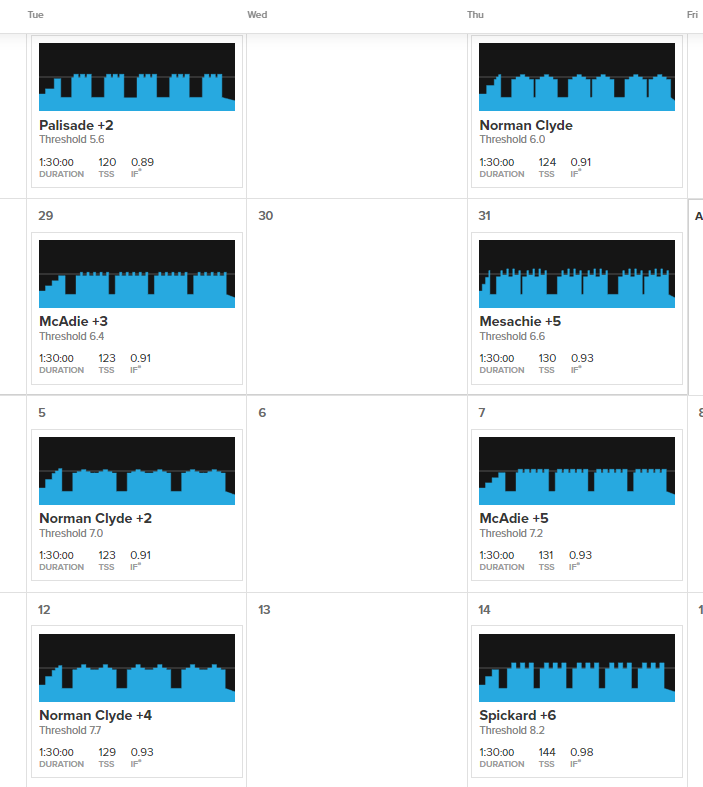

I plan to base my next 4 week block around these type of work outs having done HVLT > SST > THR > VO2 blocks thus far. After this intended Over-Unders block I will be off to Spain for a training camp in the hills/ mountains.
Here is what I am thinking over the next 4 weeks:
  • 2 x workouts per week
  • Progresion from PL 5.6 > 8.2
  • Mix of stepping/ pryramid format and traditional on/off format
  • z2 tacked onto the end of the main workouts
  • As much z2 on other days as possible
  • Expect a fast group ride will find its way in on Saturday
Planned Progression:
Week 1: Palisade + 2 & Norman Clyde
Week 2: McAdie +3 & Mesachie +5
Week 3: Norman Clyde +2 & McAdie + 5
Week 4: Norman Clyde +4 & Spickard +6
Any thoughts? Has anyone done a dedicated Over-Under block? Should I be taking a more blended training approach?
