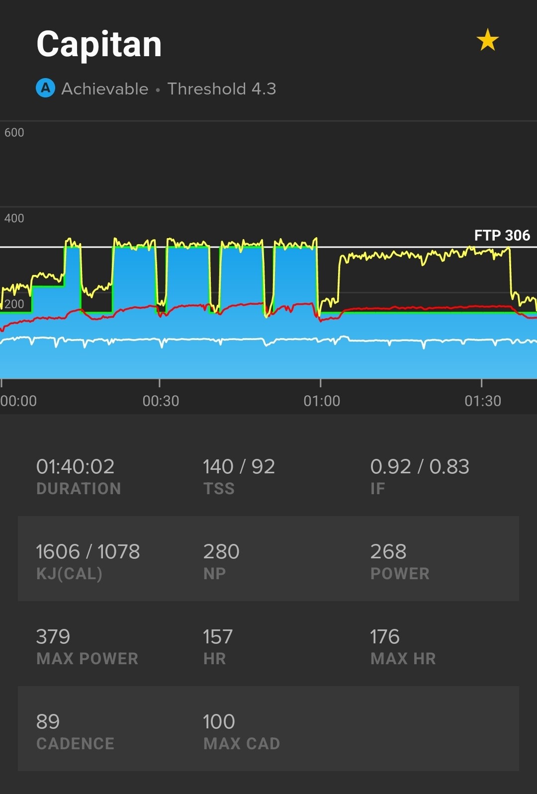

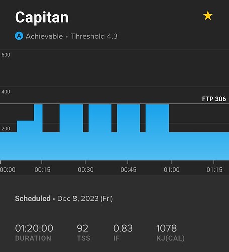

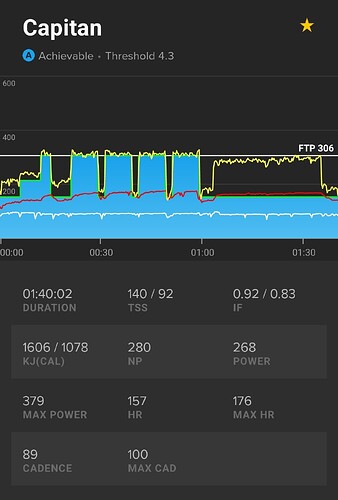

I sort of took this advice, but instead took the 2x33 and just went straight through instead. I believe I have earned my rest week.
(yes, total watts are low… I’m a lightweight!)
That’s strong though. Looks like it’s time for a new FTP-test ::
51+ minutes at 100% FTP just 9 days after a field test, should I do another FTP test?
No, unless it was easy/medium then to me, that just confirmed the FTP was accurate (assuming it was a pretty hard effort)…if fairly easy then yes I’d say FTP was higher
apologies, I must have missed the part where someone asked jlsazart if it was easy or not. I just saw that he earned his rest week, followed by a comment that its time for another FTP test.
*She. I’m actually going into Vo2 after this rather than a new FTP test. I tried gently pushing above 190w for some periods of this effort and there was no way that was going to last long, so my tipping point is still right around there somewhere, which is already at 86% of my best 5 minute power.
If I had made it 51 minutes (which seemed likely around minute 20 but then some reserves must have kicked in), I’d probably keep extending until above 1x60. At least that is what I was telling myself I would do. How did your FTP test go 9 days ago? Good conditions? Well fueled and cooled?
Also, I ended my slightly, but maybe not so, tongue in cheek comment with a smily face that didnt come through.
And indeed a 51 minute effort seems like a very good confirmation and a solid effort at FTP. Dont think i will be able to do so right now.
But 70 min is another level entirely, would not you agree @WindWarrior ?

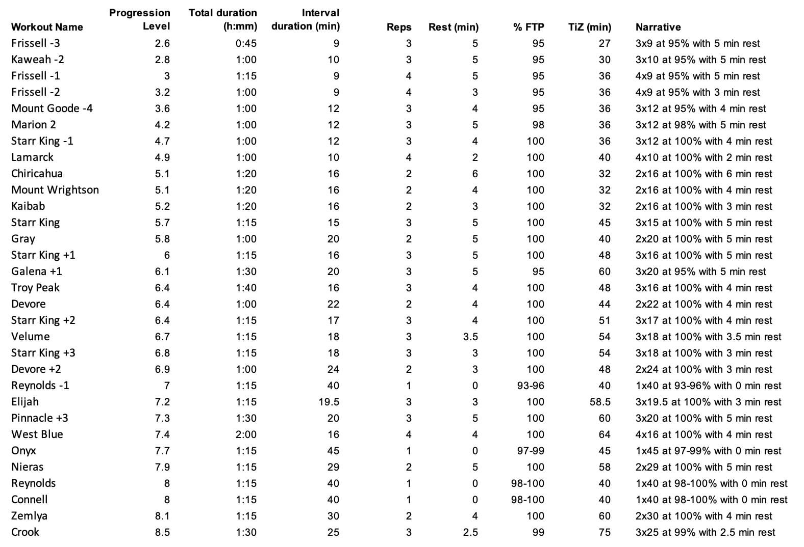

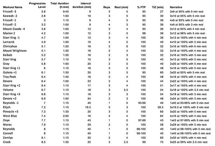

A great article that outlines what and how much for each type of workout.
What old and fast shared is more of a Supra threshold workout IMO. I do those in 5-10 min intervals, in the article they call them “hill excelerations”.
Probably just increasing TiZ in the 95-99% range. With intervals between 10 and 25 minutes.
