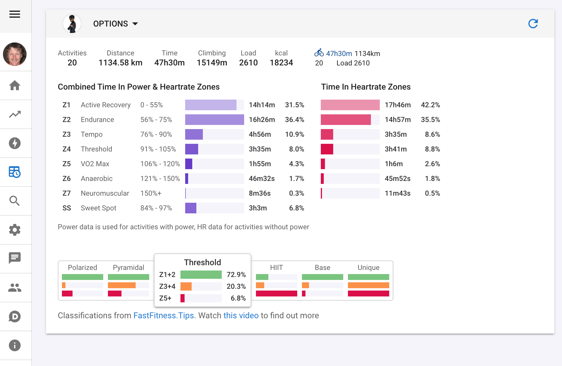

Work has started on totals for different time frames etc: Annual Total Time in Zones - #5 by david - Feature Requests - Intervals.icu Forum
