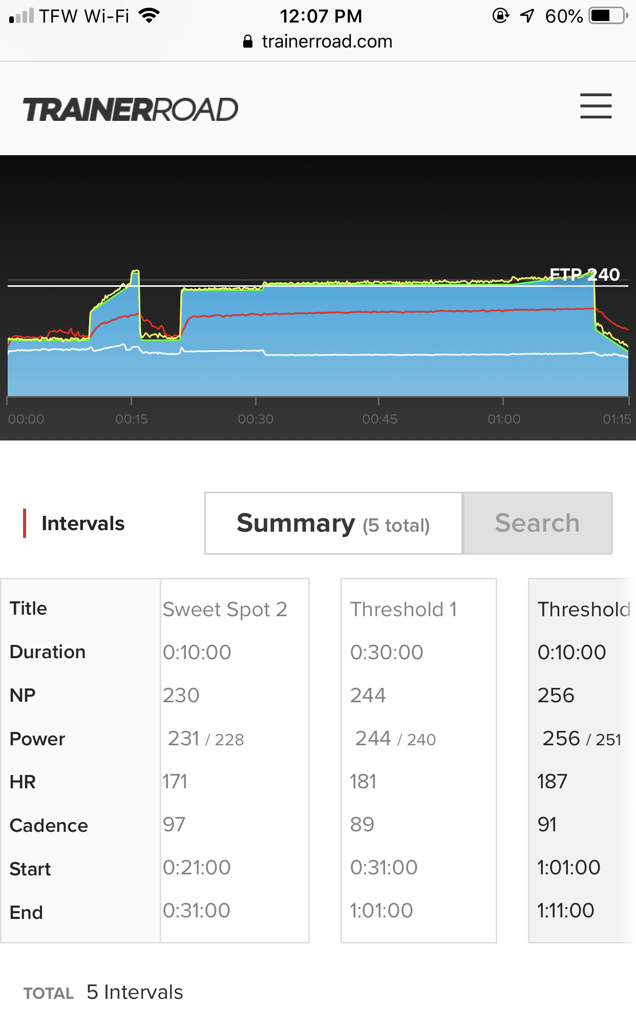

So I did a second attempt today. On Tuesday I tried it with 250w target and failed about ten minutes into the 100% segment. The FTP was 5w lower than my season high but I was coming off a two week break so that might have been hubris. I also just didn’t quite remember what threshold feels like or maybe I never knew because of overestimated ftps from the ramp test.
Today I tried it with 240w. About ten minutes into the test, I realized that I had done something around 243-244. Every once in a while I drifted a few watts up and could actually feel a difference so I forced myself back to 243ish. The last ten minutes of the middle interval felt easier and when the ramp came around, I stepped it up to 252ish for a few minutes. With 2 minutes to go I felt like I can raise it a bit more without it just being a sprint or whatever.
The average of the three test intervals is 244w. Mostly I liked the format. My TR profile is private, but here’s a screenshot of the workout summary with relevant intervals:

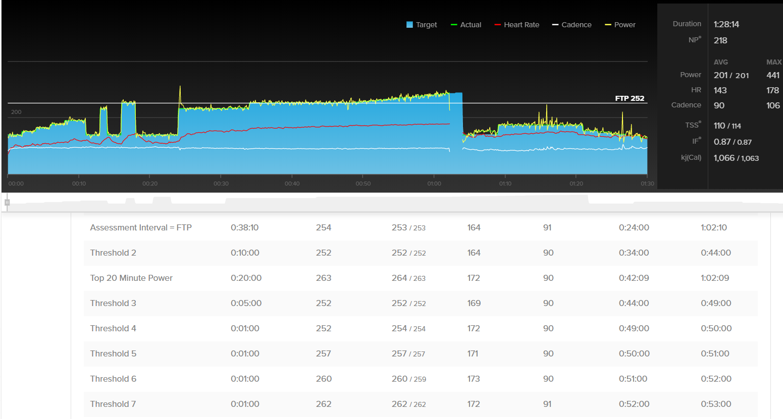

I tried the Baseline 35 - 40 minute assessment this morning, first impression is that I like it over any other assessment I have done. It will be interesting to see how I feel over the next few days but I can’t see recovery being anymore or an issue than any other Threshold testing or the 20 minute assessment.
Some WKO Stats before the assessment:
  • TTE = 38:30
  • mFTP = 247 (it was 248 yesterday)
  • sFTP = 252 (reduced from 258 earlier this week as after the Worlds as I’ve been off for 13 days except two sessions one SST and one 45 level 2, and had a cold)
  • Stamina = 83
  • FRC = 12.5kJ
I did the first 10 @ 92%, next 15 @ 100% Target FTP which was 252w, and then ramped 1% per minute until failure
RESULT
  • Managed 38 minutes 10 seconds average 253w, NP 254w (prob because a spike at the start)
  • Max 20 minutes 264w, 95% ~ 251w
  • TTE in WKO increased to 40 minutes 2 seconds, i.e +1:32
  • mFTP increase by a watt to 248
  • FRC and Stamina stayed the same, as you would probably expect
So I’ve got two numbers and could either use the average of 38:10 i.e 253watts or 95% of Max 20min 251 watts. I have my mFTP set to 252 watts and I’m leaving it there as its between the two.
Okay, I’ve only done this protocol once but would I recommend giving it go… YES!
