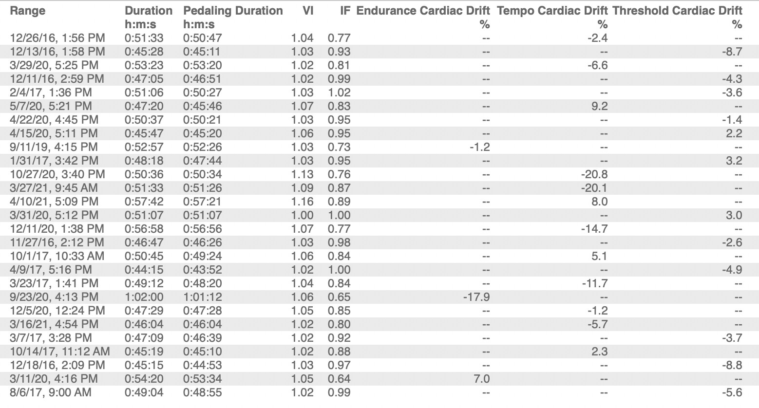

Hmm. that may be individual because I haven’t seen that. Here is an older post talking a bit about it:
and the pic from that post

  • focusing on time period from November 2016 thru April 2017 my aerobic capacity increased substantially in March however I have a December 11th effort at 0.99 IF and -4.3% decoupling

You’re comparing decoupling between rides of varying power targets and therefore getting varying decoupling results.
The portion of my comment you quoted excludes the most critical part
the majority of those are at threshold, just mentally ignore the three non-threshold (IF of 0.77, 0.73, 0.84) workouts. Therefore all but three of those rides are basically at or near FTP, and with basically no decoupling. IMHO the data tells a story.
In other words, all but three are:
  • at same relative intensity
  • on the same course and time is relative to the amount of headwind
  • over a period of many months
  • over a period of increasing aerobic capacity (late 2016 lower aerobic capacity compared to March/April 2017)
Putting decoupling into a zone bucket, workout by workout. Workouts with a low VI, say 1.05 or lower, means it was close to a ‘pure’ zone workout for that segment:

No. Its a 10.8 mile (17.4km) Strava segment that I recreated in WKO. There are a couple of ways to get to the segment, and different wind conditions, and several traffic lights and a railroad crossing, so thats why I said 15-25 minute warmup. And to be more precise, it has always taken no less than ~15 minutes to get to the start of segment and usually about 17 minutes minimum.
The chart in previous posts shows all my efforts on that one segment. Looking at VI and IF you can see for yourself there are fair number of “pure” threshold efforts (IF around 1.0 and VI <=1.02) and the resulting decoupling for ~50 minute effort is low. Now I hope we can agree that ~50 minutes is a LONG effort at threshold, and it isn’t possible to go much longer.
