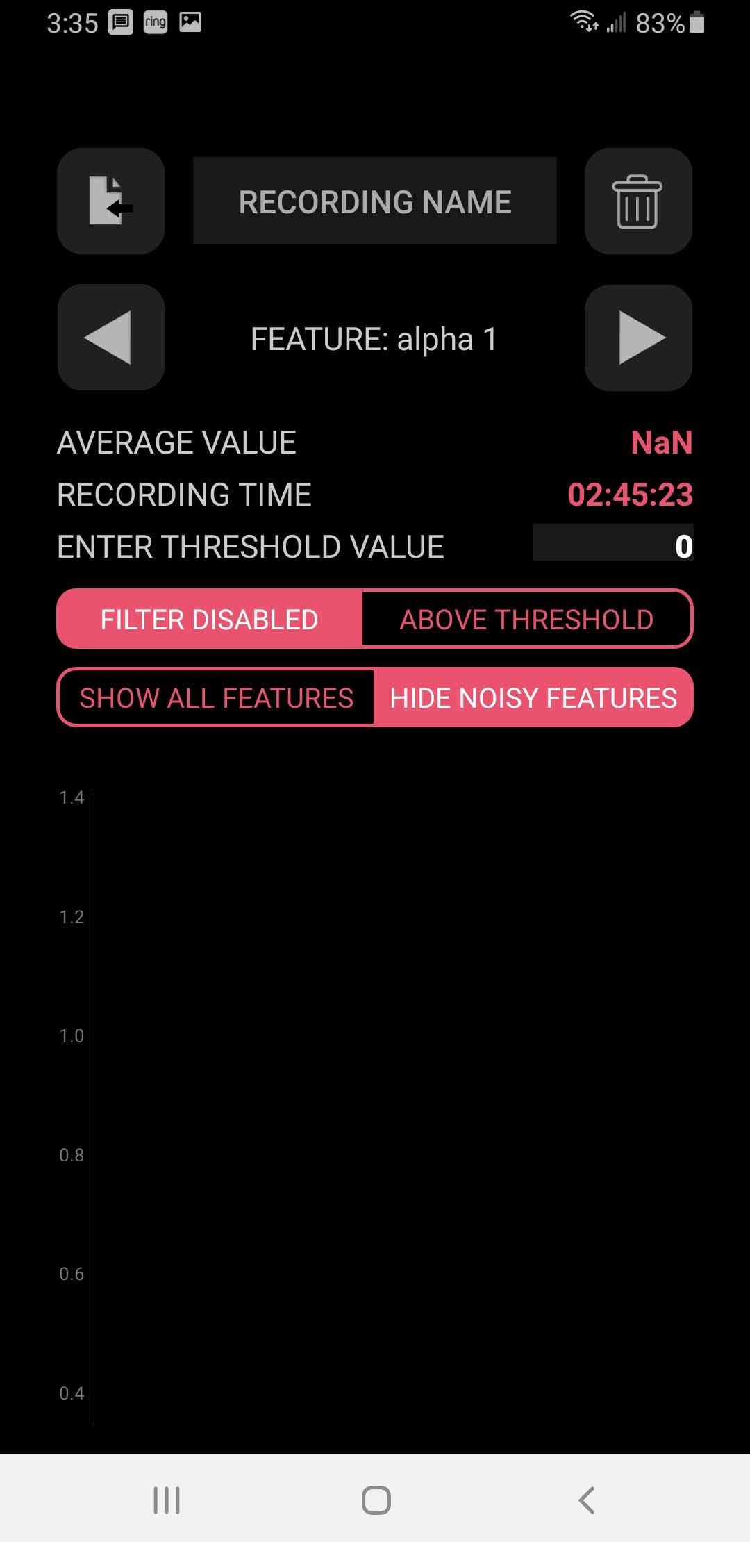

I got the HRV logger for Android, and have used it on about 6 or so rides, all steady state efforts. I’m using a tickr2 as my HRM, and I don’t think I’m getting good data. I’ve attached 3 screenshots from my latest ride, and the number of artifacts removed concerns me, as well as that I get a blank screen on the ‘alpha 1’ metric when I hide noisy data. Looks like the data is very noisy, which would explain how variable the data is when I am just riding steady. The spikes in the middle and end are when I was off the bike. I might spring for one of the recommended Polar HRMs to see if that fixes this.

Yes, this data is certainly unusable for HRV analysis (DFA or other) due to the very large number of artifacts detected. You might be able to see some of these issues for a shorter ride also by looking at the RR intervals time series, there might be more “high-frequency noise” on the signal, which should otherwise be quite flat due to the naturally low variability during exercise. Another check could be to look at rMSSD for the same recording, you would expect very low values 2-5ms, while if there is more noise, it could be a bit higher.
Unfortunately, the Tickr has provided inconsistent results so far, even here I see just the message below yours @GilbertsGrapes is reporting data that seems accurate (it is not really possible to tell without looking at the actual waveform, so we can only try to estimate the quality by looking at abnormal beat to beat deviations, which is a decent method).
On Android we have not enabled ANT for this app, so the protocol does not seem to be the problem (which instead might be the problem when using .fit files as previously reported also on this forum, when we didn’t know that ANT was very prone to packet loss).
If you have the opportunity to try a different strap or are interested in changing strap, then my recommendation is always the Polar H10, which works with both Bluetooth and ANT and therefore can be also used with other tools
@toyman definitely recommend the H10, it’s working well for me, even with running. I have had the odd recording with artifacts but it is very uncommon; I think there must be the occasional time when I don’t sit the strap correctly or something like that.
Thanks Marco - H10 is ordered.

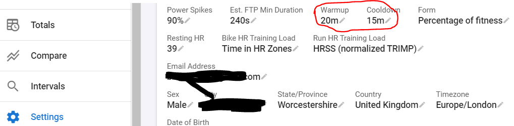

Obviously you need to be a bit careful with which data range you select, so you only have a long z2 effort and no breaks or sprints in, and exclude the warmup and cool down.

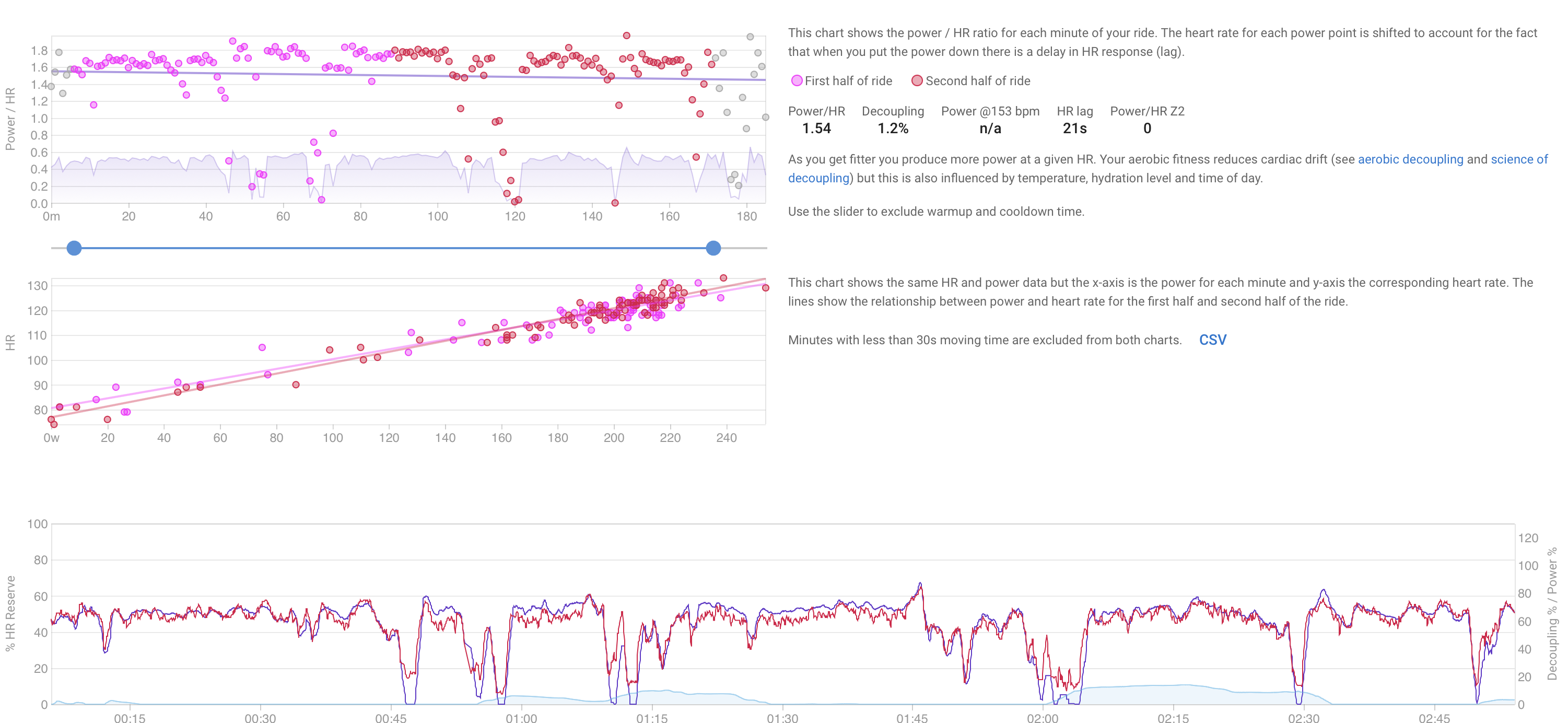

On your individual ride page go to the activity power tab on the left had side - there is more detail on the de-coupling stuff there @Shrike - will look something like this:
EDIT: Use the sliders on that chart to show de-coupling for the ranges @Bbt67 is suggesting for you :slight_smile:
As @ojtCycling said, at the bottom of the power tab for the activity. Use the sliders to pick the range of the ride that you want to evaluate (ie, without warmup/cooldown). The bottom graph shows when decoupling starts to happen, but I’m less confident in that graph.

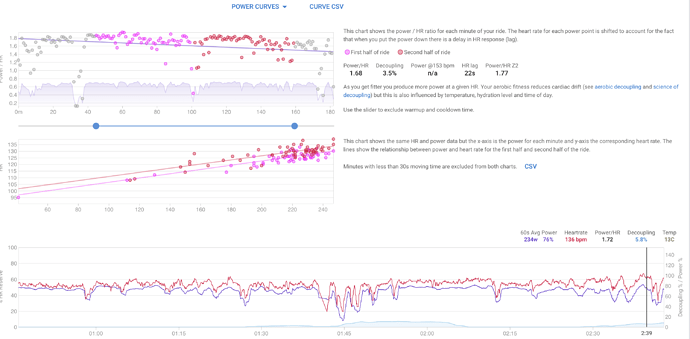

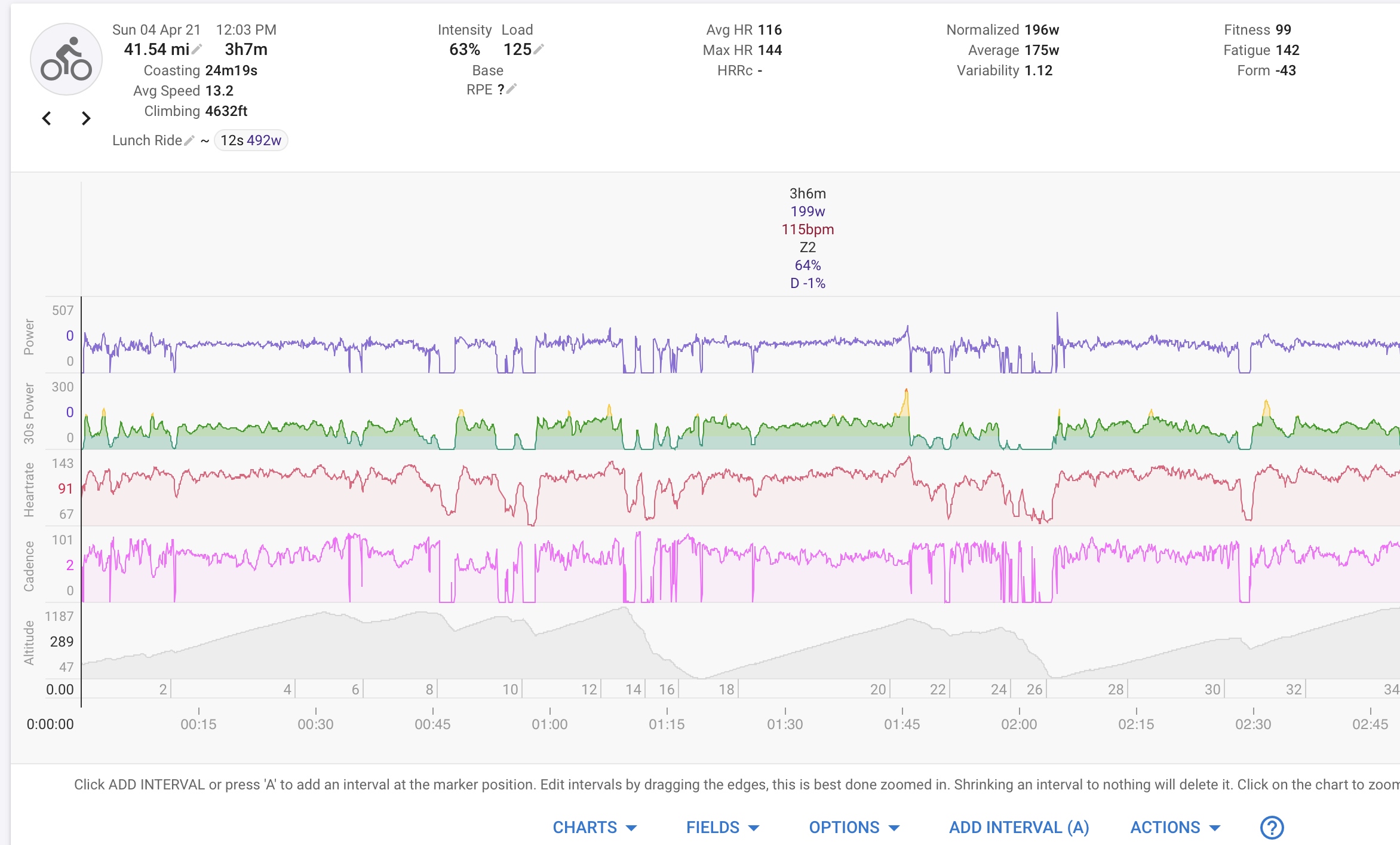

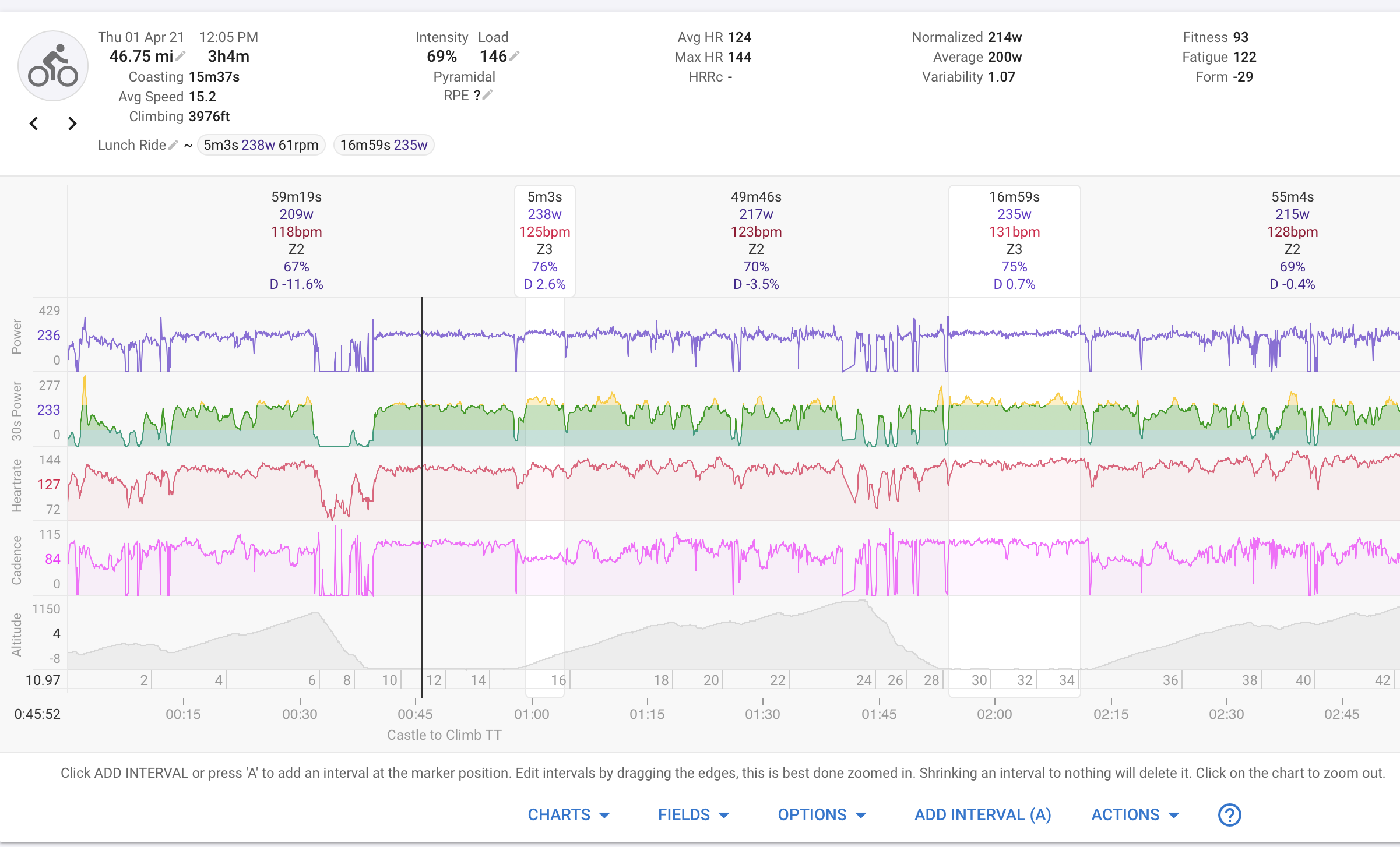

Ah gotcha, thanks guys! Never been in that area before… I had two rides up there. Both give different results though.
3 hour ride from 45min to 2hr 40
4 hour ride from 45min to 2hr 40
