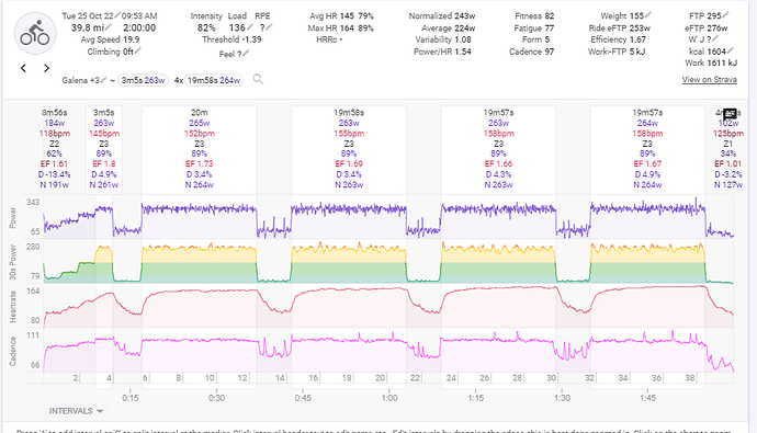

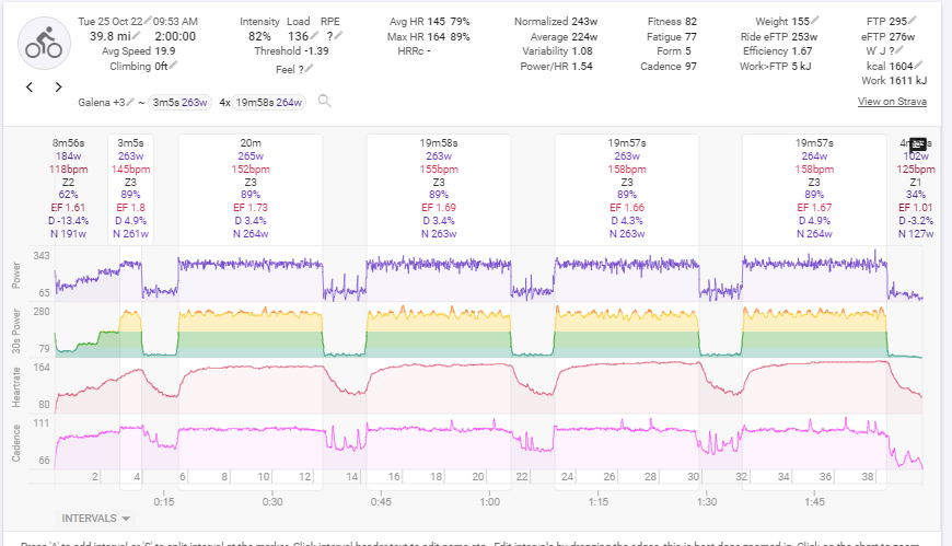

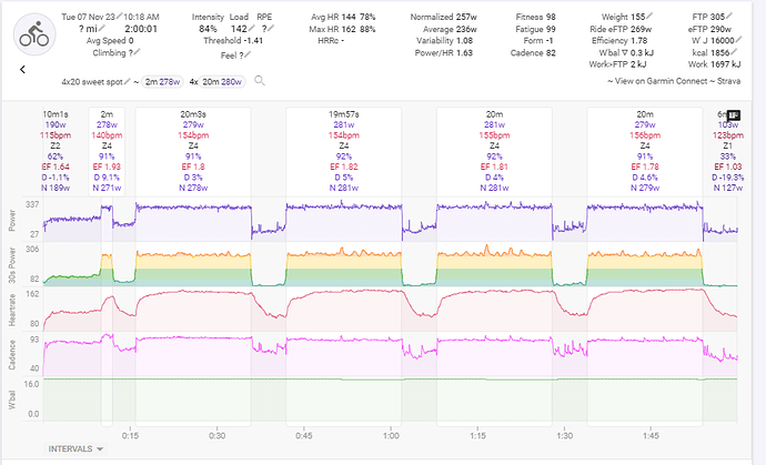

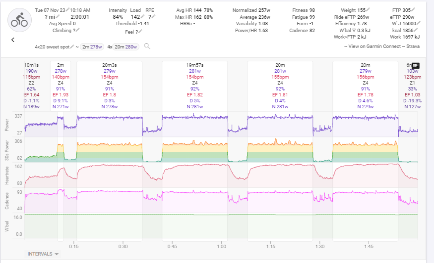

i’m personally skeptical of this strategy. i was stuck at around 290-295 for a while, and only over the last year have I managed (using my own approach) to increase 15w in ftp, so I have some idea what it takes.
Last year:
yesterday
