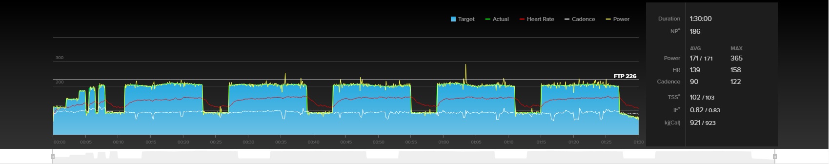

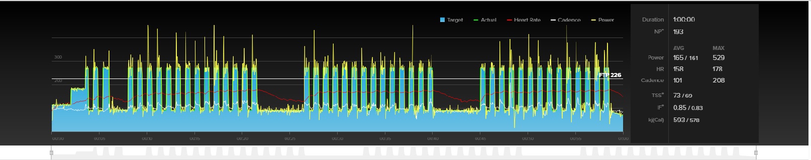

Here’s my workout from last night (this morning was Petite and nobody wants to see an hour of boring).
And here’s another to contrast, where there’s a little bit more of a steady effort, as opposed to 30" jumps followed by big drops. If the answer is there’s nothing wrong with your Neo, that’s fine, but it’s a little disappointing.
You will note that most of the power spikes corrspond to cadence drops/increases.

In some instances, it was close overall by the end of the interval. In others, it was 10-20 off. The ones where I “let” the trainer bring me up to power and then tried to smoothly pedal without trying to focus on the average were the ones where the power discrepancy was greatest. The ones where I “overcompensated” by pedaling harder and faster to try to force the Neo up to range were the ones where I came within 2-3 watts by the end. But if you look at my screenshots, you’ll see that the approach I just mentioned led to wild power spikes, which is what I was trying to avoid by getting a Neo in the first place.
Yes. That I understand. If I drop my cadence significantly, there’s a momentary spike and drop in power as the Neo adjusts. This typically happens if I get out of the saddle for a sprint or just a rest of my rear end. What I’m discussing here, though, is a little bit different. In the screenshot above for my steady-state effort you can see those spikes and they are indeed related to getting out of the saddle every so often.
