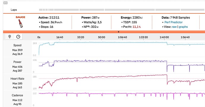

But everytime I ride outside I’m getting over 100 TSS because so many Z7 efforts being detected (riding with power)

I want to progress through in a realistic way this time and not with messes like this (look at the cadence and inconsistency in power) at this time I was so pumped with the power PRs I was setting and my 4w/kg FTP, I didn’t have the awareness to notice that I wasn’t anywheres close to doing these workouts as intended until I did a consult with a coach.

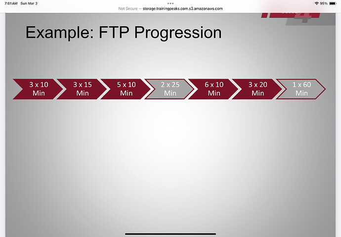

I would recommend being more simple with your progressions and progress total time and interval time at 90% of a solidly tested FTP as your starting point. That’s what this thread is all about! :slightly_smiling_face:

Are you using the same power meter for the outdoor workouts and the TR workouts? If not, what is the outdoor power meter? Could you post a photo of the power readings?
I think they are accurate, just me riding dumb, hitting little climbs and bits of singletrack hard on an otherwise ‘social beginner group ride’.

Idk what ‘Lola’ is or exactly what SS90/50 is but you should certainly be able to do 1x50 SS at your current FTP before you consider bumping it up by any significant amount.
