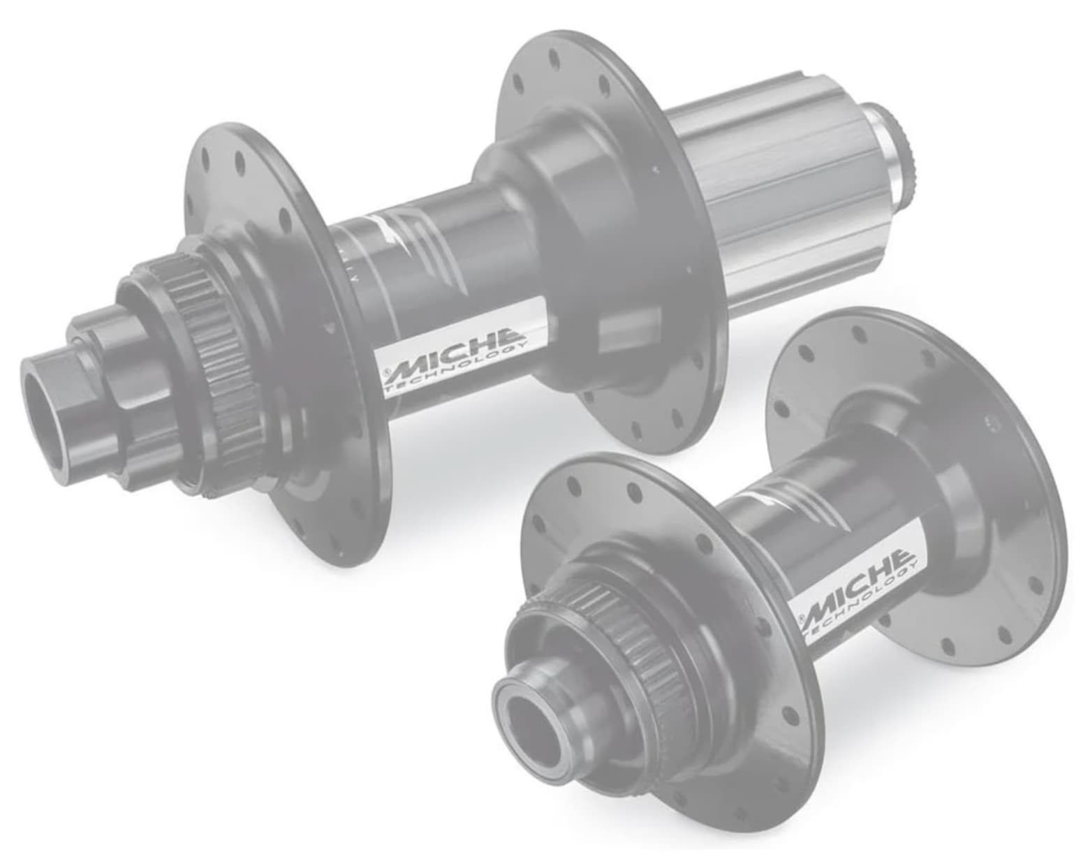

Here a pictures of a Miche Primato Syntesi hub with a CL in the middle and the Syntesi looks a bit more complicated to disassemble.
And these are supposed to be the Miche Race CL hubs, the ones that look like the DT hubs.
There are flats on the axle, so you might need to loosen and remove the axle to pull the hub off. Good luck…

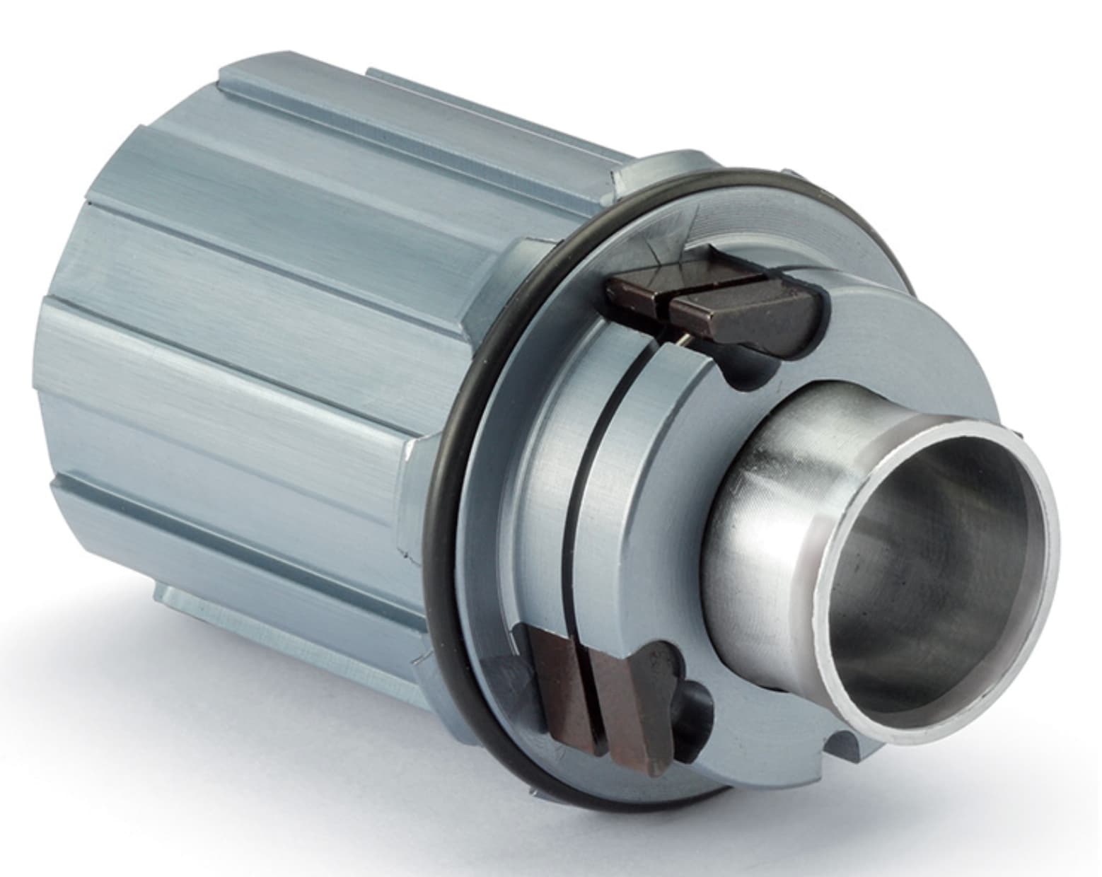

The body?:
Dude, you’re a legend.
In >25 of cycling I’ve only done hubs bearings once and never any with a freehub so hopefully these pictures and descriptions help.
