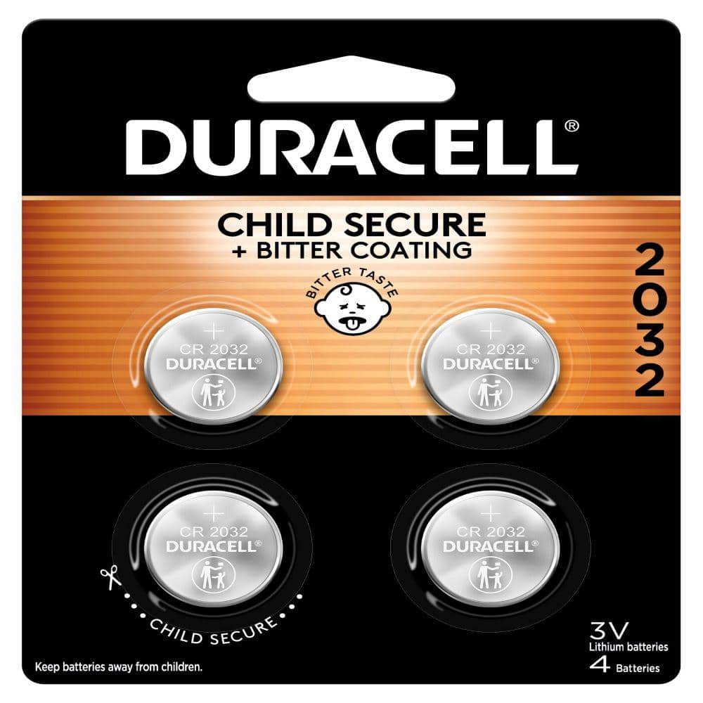

The best thing I did for my Stages was stopping buying the cheap 10-20 packs of batteries off Amazon. Some worked and some didn’t. They don’t last as long and worst of all performance would be erratic.
Since switching to fresh retail packs of Duracells (the kind you might see at Walmart), my Stages has been flawless. This was after two years of dropouts and inconsistent performance.
