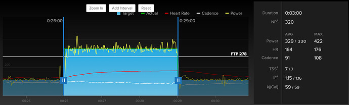

I don’t really have a frame of reference here since it’s the only smart bike or trainer I’ve ever used, but it seems fine to me, I don’t have any complaints. I generally have no trouble hitting my power targets, unless it’s a very short interval (less than a minute). Here’s one from a VO2max workout I did last week:
Thanks! Seems to be a lot more “noise” than when I compare it to a similar length VO2max interval using my OG Tacx Neo - albeit I am sure we are not comparing apples to apples etc. although I don’t think I have any smoothing on etc.
