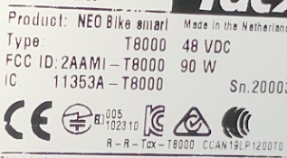

I think if you look into the erg issues, you just need to make sure the version of bike you receive is of X model version, as soon as mine arrived I checked that and was all good. Anything prior is a likely. A problem
How i can check if it is a X Model version?
Pretty sure it said on the box the exact model, so you could as the reseller to confirm before buying it.
L
oh shit, the big box don’t exist anymore, it was destroyed because my Bike store assembled the Bike for me and transported to my home 2 streets away of the store, i only have the 2 small boxes with the bottle, bottleholder, Zwift Coupons, Tacx Training Software Coupon and so on
I’m sure it will say somewhere on the bike itself. Just found the model that has the issues resolved is: T8000.62.
Found it via google on the Wiggle Q&A sections where everyone is asking the model versions…
Thats all i can find:
there is only T8000 or is it T8000 48?
T8000
and the 48 is for 48 Volts DC (VDC) power input.
Mine says the same. And mine is definitely the later model. Not sure how else to check, maybe contact tacx?
But then, if you’re not having problems with ERG - probably is the correct version?
yes, haven’t problem with ERG, but would be interesting what version, i will check the Tacx App tonight where you can install firmware!
