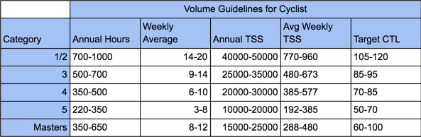

Came across this interesting chart from TP in my research earlier:
volume%20guideline

I’ve seen that chart, too – made me think of something I’ve overlooked in my last Build block: total TSS.
The TR SPBHV plan is a total of 73.5 hours and 4,345 TSS, ~60 TSS/hr (IF av is a bit trickier) – 9.2hrs/543TSS/wk.
The block I did was a total of 58.5 hours and 3,737 TSS, ~63 TSS/hr – 9.75hr/622TSS/wk.
My TSS/hr was 5% higher than the plan; TSS/wk was 16% higher.
[edit: for total disclosure, my recovery week has been a true Recovery week vs. the TR Endurance recovery week. Biggest ride has been Beech (43/0.65). And it’s taken the full week to shake that fatigue. Ramp will tell if I did a good thing or over-cooked it.]
I found it challenging yet doable. Pretty sure if I did the mid-plan recovery week (instead of removing it), I could have done even more. Considering all the workouts (including subs and additions) were 0.80+ IF, I wouldn’t see a problem adding extra 0.70- IF work into a plan.
