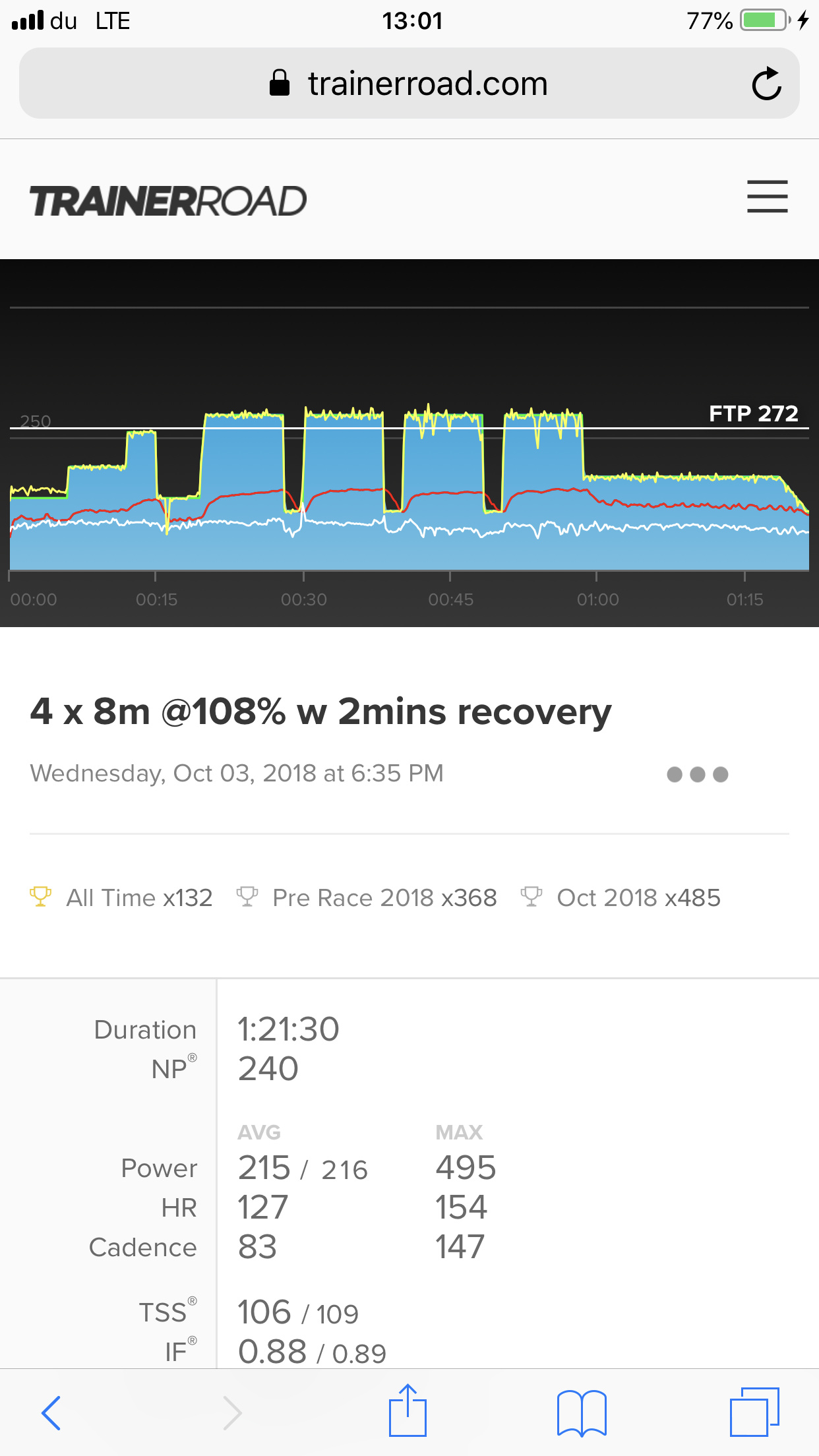

I did it a while ago.
Ramp test was 17th September. Started to fade a little on the 3rd interval. I don’t actually think that my heart rate was that high or high enough for what everyone is talking about it needs to be for the benefit.
Was feeling stronger another time so did it with 5 minutes rest followed by some sweetspot.
What was the intensity factor if you just select the work period (i.e. from the start of the 1st to the end of the 4th interval)?
Trying to do it on my phone and it’s saying 1.01
Sounds like that’s in the very tough but not impossible range - although I think you’ve said in the past you’re in the minority of people for whom the ramp test underestimates FTP?
