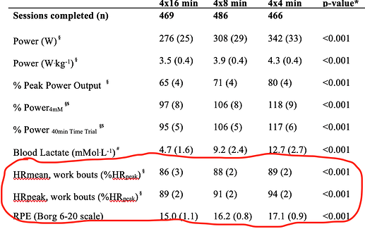

Here ya go:
Hmm. Yes, you’re right, looking at a table from another study.
So, with average ~88% HRmax, peaking at ~91% HRmax, RPE (average of all 4 intervals) of 16.2, is the Seiler protocol… not that hard?
