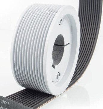

  • Again, this comes down to the change of using a poly-v belt & pulley system. This is inherently more quiet and is what Wahoo made in their first truly quite trainers. Saris and others followed suit and matched that change.
  • image
  • Not all the pulleys have matching grooves, but this is more quiet because it lacks the trap & release issue of the cogged system at the top.
