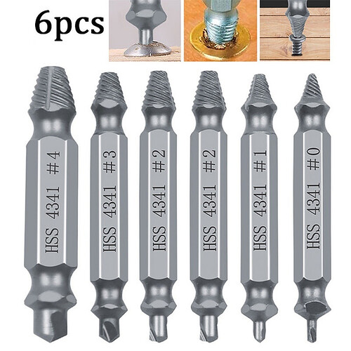

Posted a while ago about my belt wearing, must have been misaligned from new. Saris sent a replacement belt kit which includes the tools as the first 2 steps requires a 5mm hex, a 1/8 hex and a t-30. To take the side panel off you need to remove 2 t30 bolts and 5 1/8 hex bolts, these 1/8 bolts all have loc-tite applied and are torqued down very hard, 3 of them stripped so I’m stuck with 3 of 7 bolts stuck and stripped preventing me from changing the belt…
Just get a reverse-thread bolt extractor and you should be able to remove them.
Yeah going to have to get something like that, just an annoyance, wanted to get the belt replaced tonight and now won’t be able to get it done until I can pick one of these sets up tomorrow, gonna have to make sure I get one small enough to fit the 1/8" hex head…

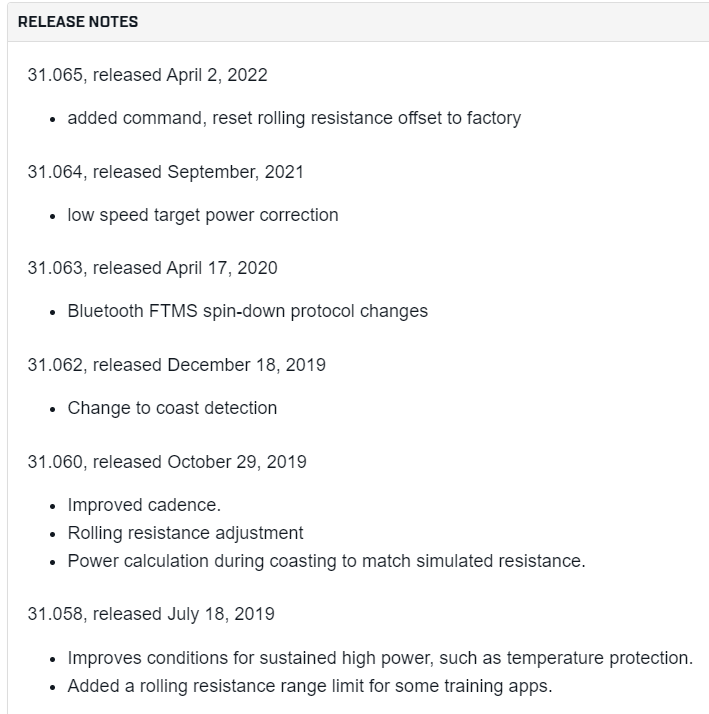

Not the answer you want, but if you are on one of the later FW versions, there is not much need to be on the “latest” one.
Just a snippet of the full list:
Unfortunately it is the 31.058 firmware build. The production date is end of 2021 if I understand the serial number sticker on the H3 correctly.
