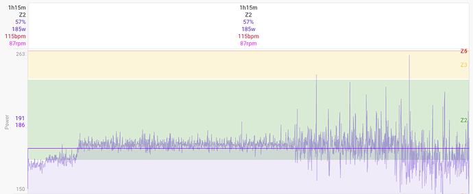

Hey all,
I use Assioma dual-sided power meter pedals with PowerMatch with my H3 in ERG mode, and accustomed to the usual spikiness (i.e., oversteering above & below the target) that goes along with PowerMatch. That’s why I’ve been surprised a few times in the last few weeks when actual power has been locked onto the target power exceptionally well. It locks on so well that I can’t even get it to deviate by significantly varying my cadence. That said, this ideal ERG mode behavior seems to be the exception, not the norm. I’d love to be able to get it to behave this way ALL the time, but can’t figure out what variables are contributing to the better PowerMatch behavior. Does anyone else experience this same difference - PowerMatch sometimes performing very well and at other times super spiky? I’ve attached screenshots from a ride I just completed where the first half of a 1h15min Zone 2 interval was VERY locked onto the target, but then begins oversteering and becomes spiky during the last half. The second screenshot is intervals.icu’s view, with the y-axis scaled to make the difference more noticeable. Anyone out there have similar experiences and/or know of things I can do to make PowerMatch consistently reproduce the smoothness it did during the first half of this ride? I have already tried messing with the trainer sensitivity setting, and have decided that it doesn’t really make a difference, so I just leave it set to the default (0.5).
Thanks!

@koalb I disagree. The oversteering in ERG mode is not from signal drops. Here is all of the data from the .FIT file.
No zeros in the second half at all, so what else could be causing the resistance oversteering?
Looking closely at my non powermatch, steady state rides on my H3 mine consistently look like the end of your ride. I think the ‘anomaly’ might be the very smooth data at the first part of the ride, not the rougher section at the end. I don’t know if my experience is representative of others however.
@toyman I know, right? So what I’m really trying to figure out is what I can do to make the H3 behave more like the first half of that ride.
I agree with @toyman. If I saw that data file in my ride history I would assume that power match was turned on, but didn’t connect to my power meter until the second part of the ride. My understanding is that TR will fall back to using the smart trainer’s power if it can’t connect to a power meter when using power match.
Everything I’ve ready and experienced says that you just don’t get power measurements that tight to the target using powermatch. The best results I’ve had with powermatch tend to be at lower flywheel speeds, i.e. lower gearing and sometimes lower cadence
