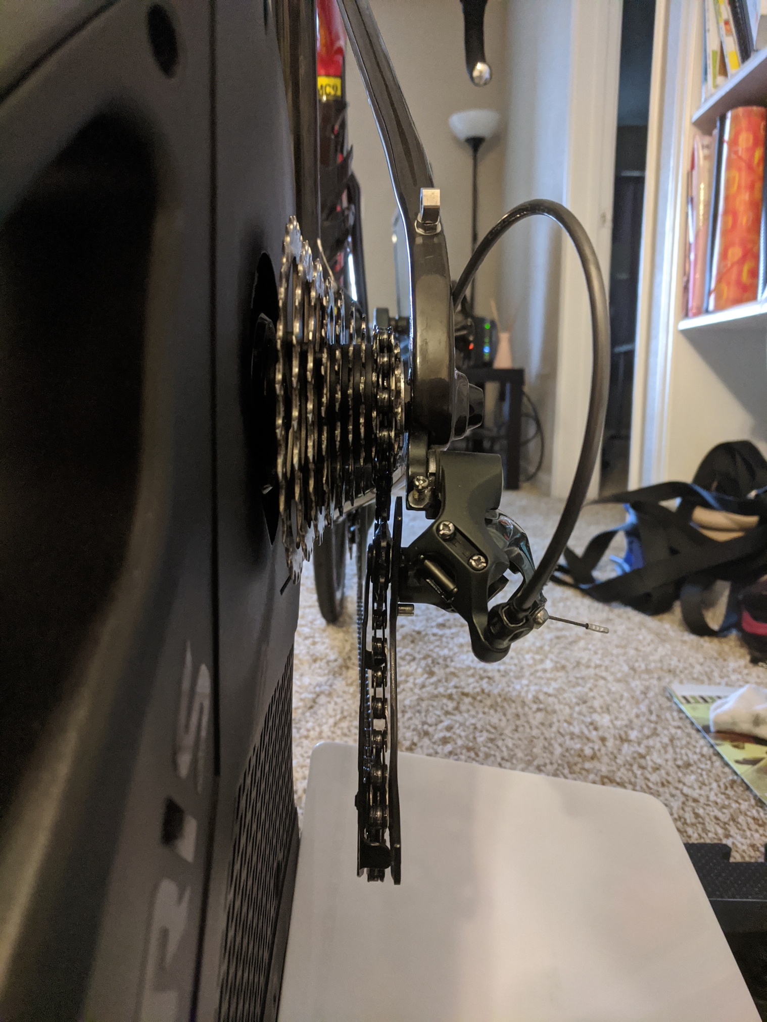

I’d like advice on aligning the chain and rear derailleur better. I used the spacer with my a 10-32 Shimano cassette. When mount the bike onto the trainer (on the smallest cog), the chain tries to jump up to the next cog
Here’s a video of the chain. chain issue - YouTube.

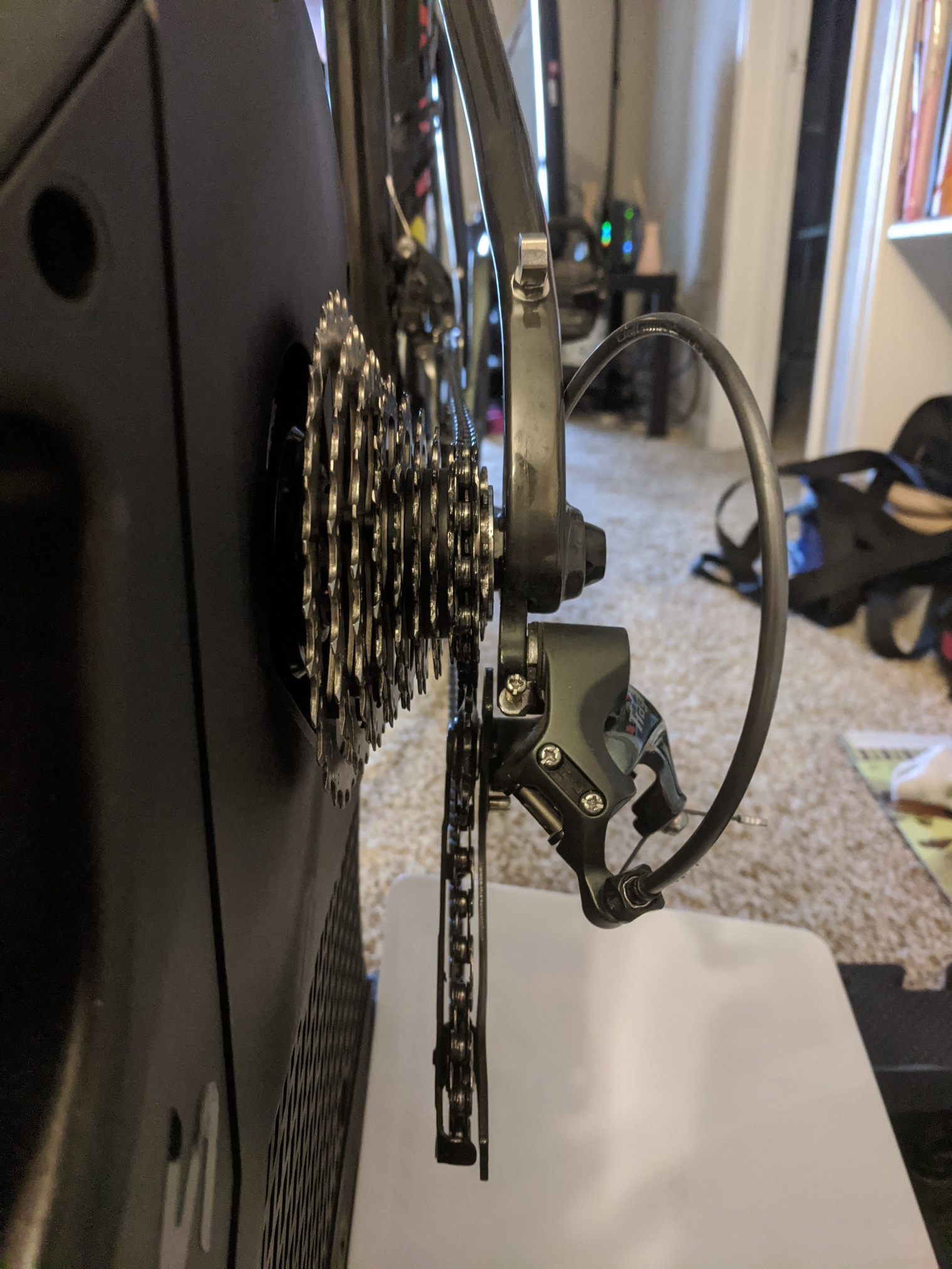

Here’s photo of the aligment ( i left it the 2nd smallest cog for now, because it won’t stay in the first)
I turn the barrel adjuster clockwise to slacken the cable but that didn’t help. Is it an indexing issue?
Also, I mostly ride on the small chain ring/middle cassette, Should I just adjust the barrel adjuster so it’s not noisy in that setting?
Typically quietest is straight chain in the middle of the cassette in my experience. As far as barrel adjuster more than likely it has to do with the spacer without even looking at the video.
Could be that limit screws that need adjusting or as you say cable backing off.

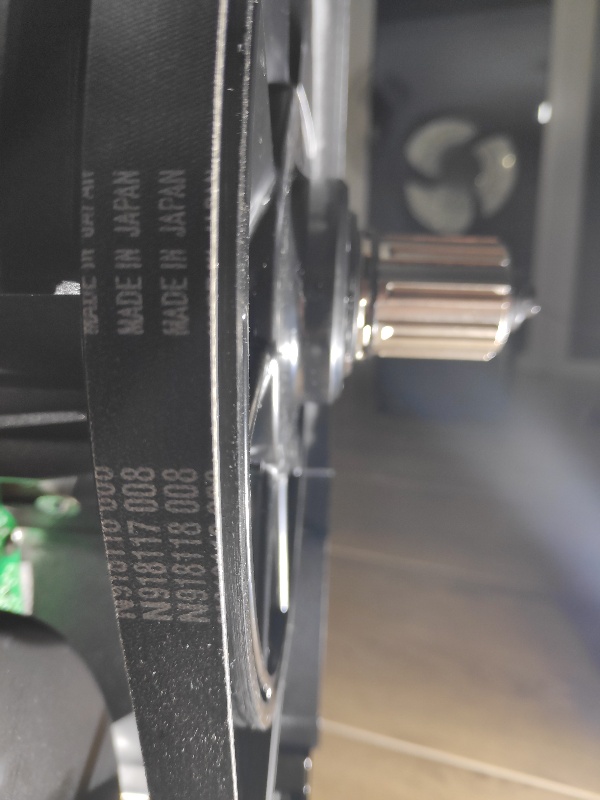

If the belt is rubbing what would the fix be? New belt?
Do you suggest removing the spacer even though i’m using a 10spd cassette?
Not necessarily as it was a suggestion just thinking it is possible but unlikely. I did not realize or missed you had a 10 speed.

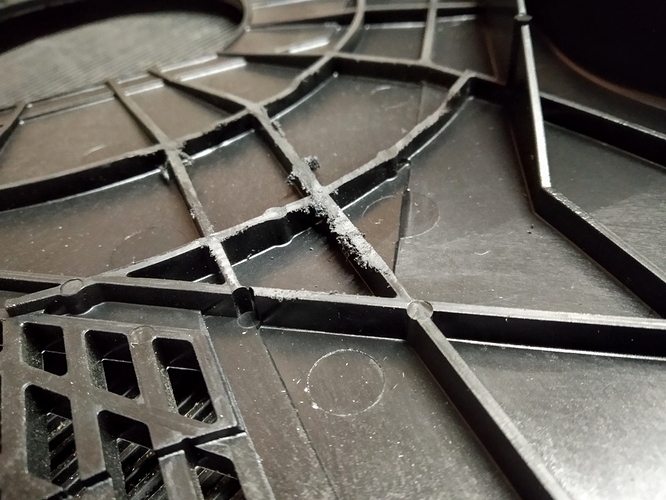

I had a loud scrape sound during low rpm, small ring situations. I opened up the case and found that the large fanned pulley/belt had been scraping away the casing. I sanded away some chunks of plastic holding on and put the case back on WITHOUT bolting it down. This left about a an extra 1/4 inch between the case and the internals. Still plenty of space between the cassette and the case. Scrape was completely gone. I’m either going to modify the case further or add some spacers to the bolts. Pretty silly, but it’s been a great trainer other than that sound. Glad to be rid of the scrape.

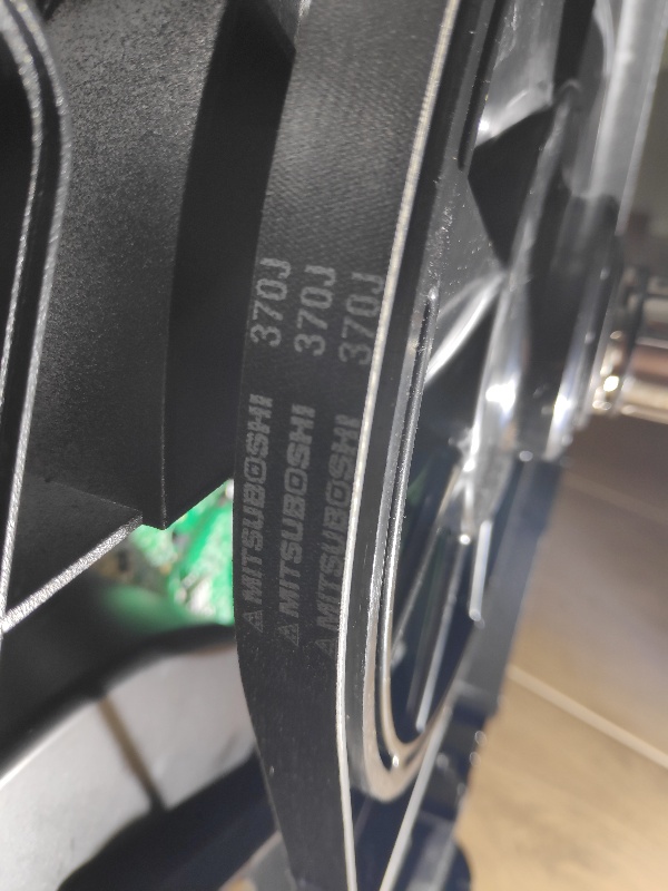

I had to remove the plastic cover to find the references and to be able to buy a replacement strap

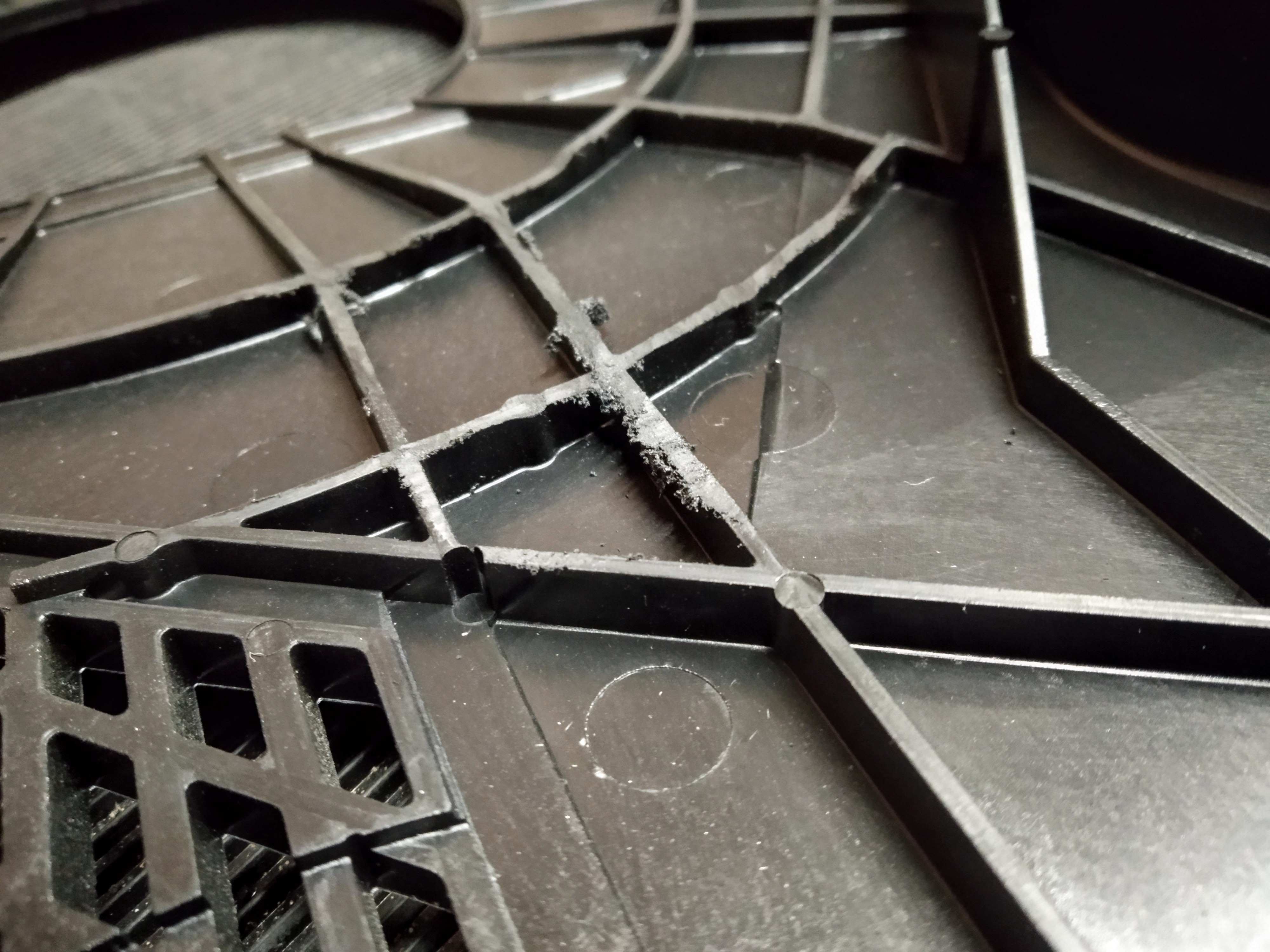

I’ve found a scraped away plastic area about 2 inches across on the inside of the case “lid”. I couldn’t figure out what was doing it though (or even if it’s been done by someone else then returned).
I do like the H3 (used 90% in practically silent ERG mode since I got it a month ago), but the noisy grating creaking due to the smooth pulley (the fact that sanding it apparently sorts that issue), and now this, is making me wonder.
Sanding is a temporary fix. The heat inside of the unit, combined with pressure from the belt, softens the plastic enough to melt it back to a smooth form. I think this is why I initially had good luck with the sanded units and then they degraded over a period of 3-4 weeks and made noise again. They could have added a more aggressive texture, or made the pulley out of something other than plastic to interface better with the belt. Or they could have just made the pulley grooved corresponding to the belt like every other trainer that does not have this problem.
I’ve not had any issues (other than the belt torque noise) and can’t see what caused this or when it happened. Makes me think I may have a return from my reseller.
This is the same scrape pattern I had. I ended up only bolting down the case 80% or so of the way to create some room. That solved my noise issues. Haven’t heard from Saris yet.
