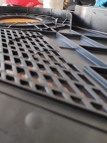

In my training the plastic cover has the same scratches … I think the reason for the scratches is due to the proximity to the upper pulley and the oscillation that it has when applying force.
I have scraped the plastic cover with a cutter to gain space between the upper pulley and avoid rubbing with it

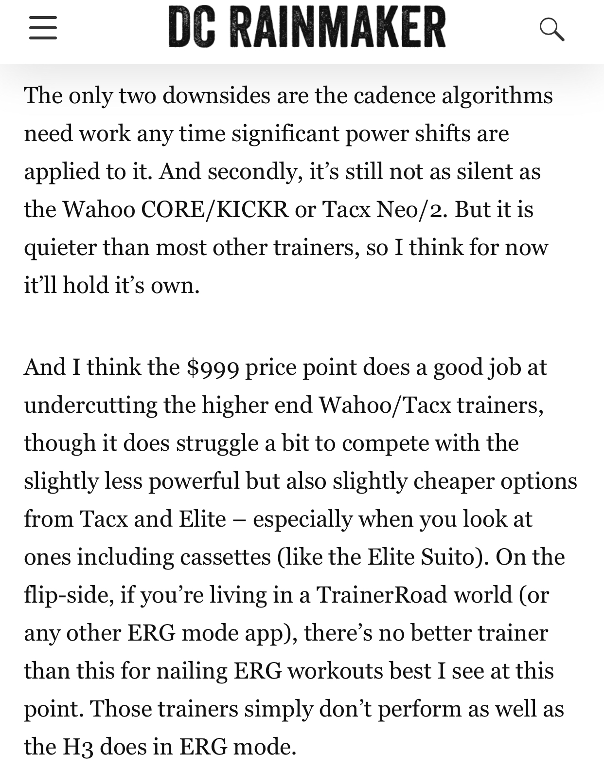

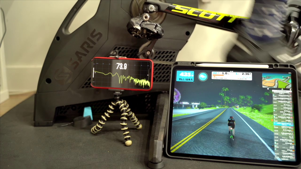

A good example on this YouTube channel, the Saris H3 was the quietest of all the rollers that passed its tests.
The coupling of the belt and toothed pulleys horizontally in the cycleops are the reason for the loud sounds that this roller emits
That first video is not a very good test, DCR doesn’t even do decibel tests because they can be skewed by so many things. Using what’s likely a free cell phone app is not really proof of anything. In every test I’ve seen the Kickr is quieter, and personally having used both, I can confirm that as well
