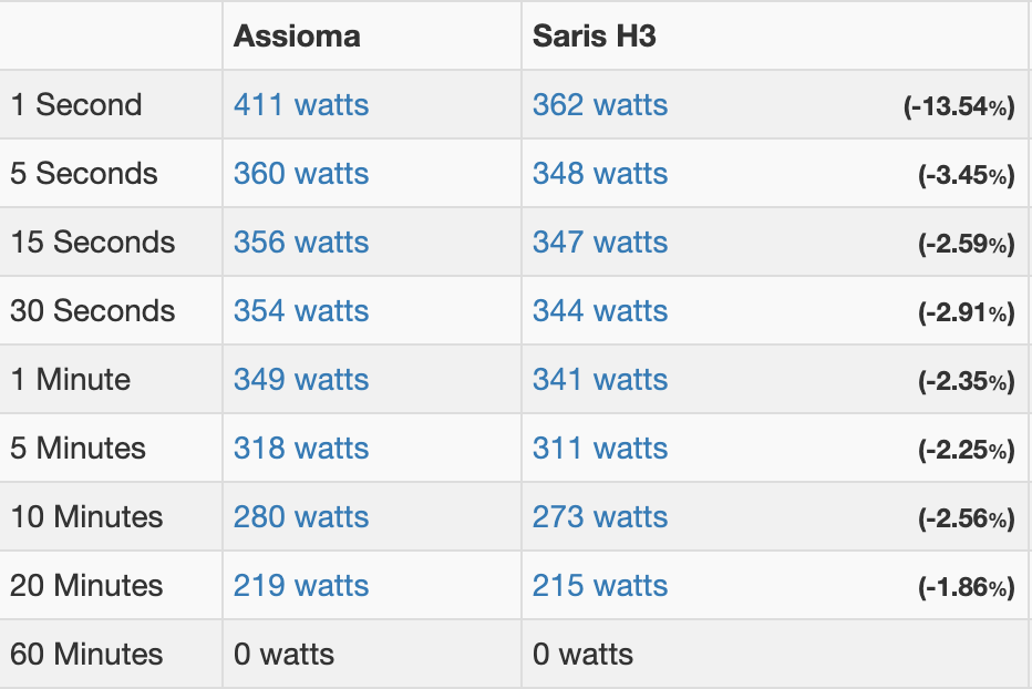

Did a ramp test with TR reading and controlling H3 with Garmin connected to Favero Assiomas - pedals typically read 2-2.5% higher which seems reasonable considering drivetrain loss and accuracy margin… Only area they are significantly off was a single power spike that skewed the very short duration power numbers.
