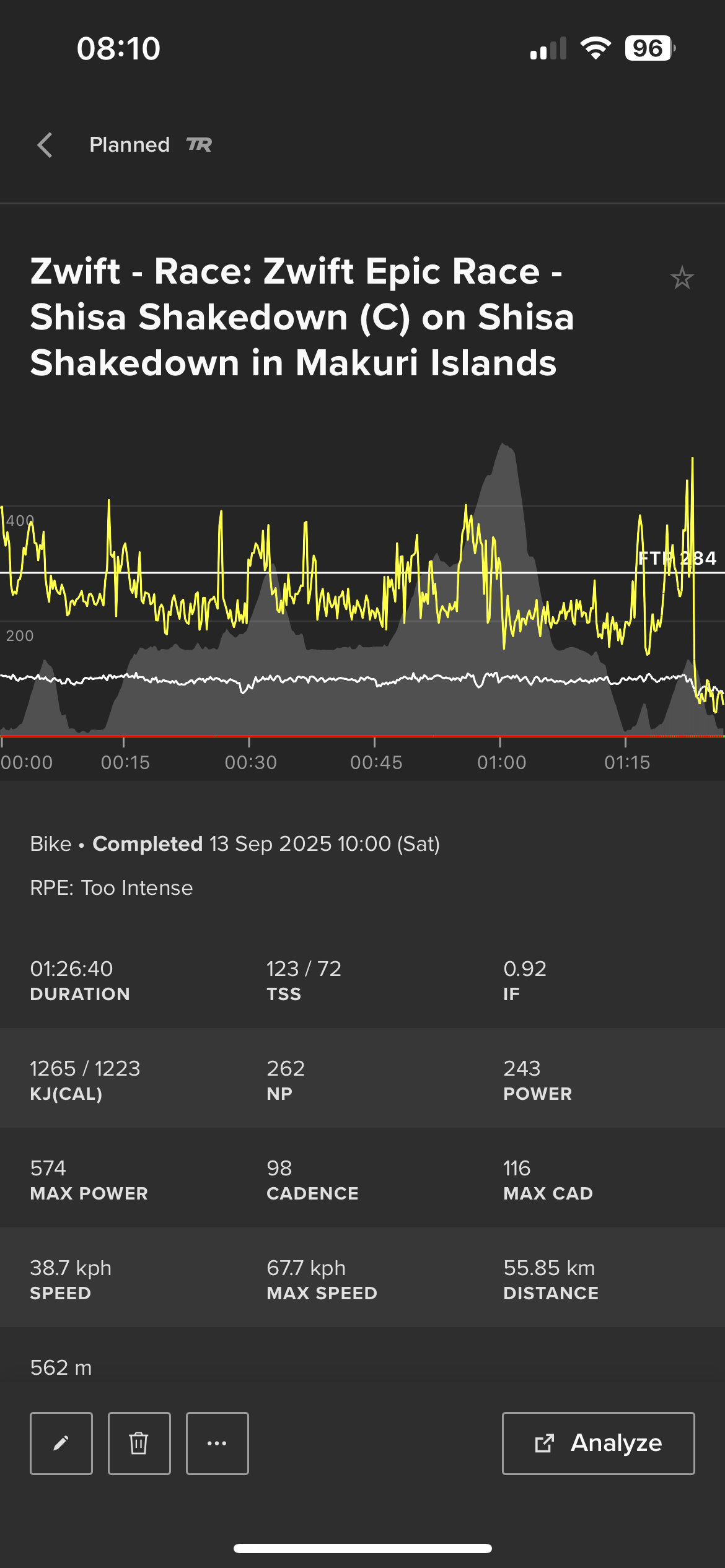

Completed a Zwift race and set my best ever one hour power. Went to label it as ‘hard’ but TrainerRoad then cut to the ‘workout too intense’ menu that comes up when you fail a workout and it asks you why.
Ride is now labelled ‘too intense’ which I fear will screw with my AI FTP and the build phase I’m about to hit.
Just want the ride labelled as ‘hard’.

Sounds like a bug - is the ride liked to a TR workout at all? I notice it says “planned” at the top of your screenshot?
I’m wondering if it has been erroniously linked to a low intensity workout that shouldnt be “hard”?
You are exactly right on why this has happened. Only spotted that myself last night. Had a three hour solo endurance in the calendar, did a Zwift race instead.
I’ve now removed the association between the rides but no option to change RPE any longer.

I took a look, and it appears that your Zwift Race is still associated with the Endurance workout Boardstone -2. I am going to see if the ride recovery team can dissociate it, as I think this is what’s causing the issue.
I will also see if we can change the survey response to Hard, as the 7-day time frame for being able to adjust it has passed.
All that said, this won’t affect AI FTP Detection as it’s taking millions of data points to detect it, so just a mislabeled survey response won’t affect it. It also won’t drastically change the Build Phase you are about to enter, as our system looks beyond Workout Levels/Survey responses, factoring in your fitness, recent training, and overall trends to pick the right workout for you that day.

What you experienced is a bug, but rest assured, this is just a display issue when disassociating the ride; it looks like it’s still associated when it isn’t. Nothing gets affected on the backend.
It looks like the survey response was changed to “Hard,” so we’re all good now!
