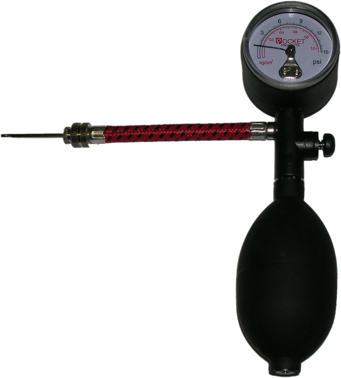

For pumps, this is a great option with low pressure control:
But short of that. Just fill up one side, balance the rocker with pressure in the other side, hop on and see how it feels. If you want more pressure, add to both to keep level. You can fine tune by feel with more or less pressure on either side to nail the level balance.
I did 4 years on a rocker without a pressure gauge, so it is very possible. Just takes some experimentation. A pump helps when you are trying to maintain your finalized settings, but is not a requirement.
