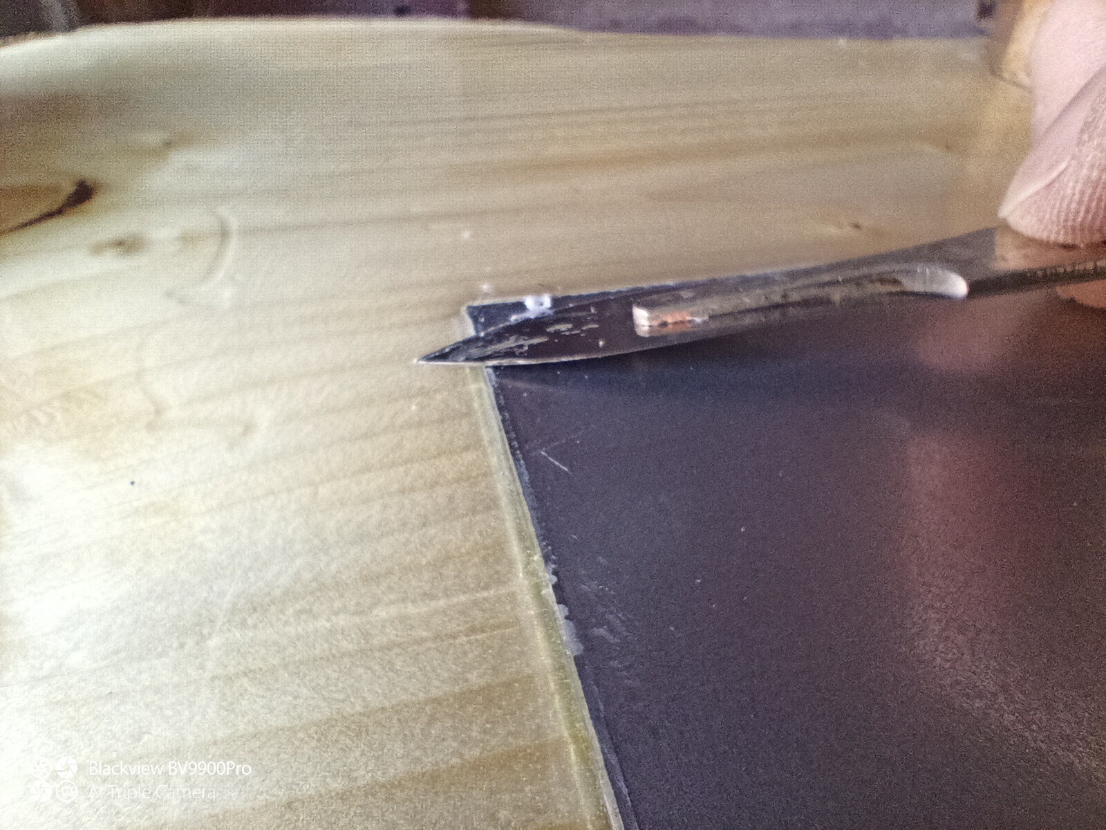

Well it’s taken two days for epoxy to cure, diesel heater working overtime in the garage. Going to delay top layer until weather warms up a bit, something above zero outside so heater hasn’t got its work cut out.
Removal of taped plates went well, only a little clean up required.
Had some tape leaks but nothing bad, will secure tape better, use heavy duty stuff when doing top as it will be a denser layer. Also will use clamps from start.
Only a couple of ripples and one little wood chip in epoxy, also some scratch marks showing through that I didn’t see pre pour which really stand out with epoxy. Not too concerned as this will be hidden and a good result for first epoxy pour, plenty of lessons learnt
Overall very happy with results, bottom is now well strengthen and protected. Think I’m still going to give it another 48 hours before prep-ing for top layer.
