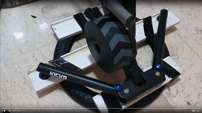

I made my DIY “rocker plate” from motorcycle tire and tube like this. It’s probably one of the simplest design you can have, and you can adjust the ‘suspension’ simply by adjusting the pressure of the tire.
It helped me got through the first few months of indoor cycling back then during the start of the pandemic.
A. Genius. B. I’ve never seen a tyre that small. C. from where did you procure it?
I forgot the exact size of the tyre, but I guess it’s for small underbone motorcycle that is very common here (in Indonesia). I bought a generic one from an e-commerce site.

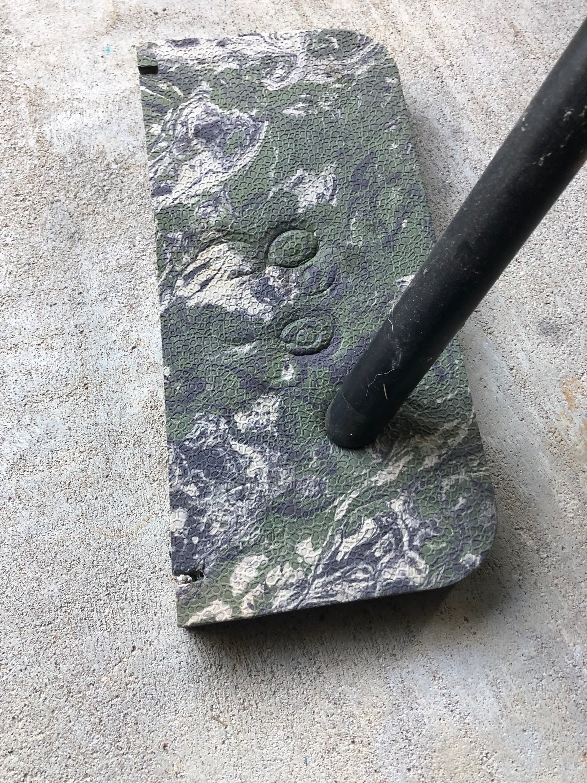

I found a gardeners kneeling pad at Lowe’s. I cut it in half so I had two pieces. I cut one of those pieces in half. The two smaller pieces go under lateral supports of my trainer and the larger one goes under the rear support. I put two small rugs under the front wheel block to level the bike but it also allows the front of the bike to move as well.
The foam will compress and the you might as well be riding on concrete so every 3-4 sessions I just move the foam a little bit so the supporting points are on fresh foam. I do the same with the small rugs.
This was just so I could try out the concept of the rocker boards allowing motion. It worked so well for me that I didn’t feel the need to make or buy a rocker board. Its also very low cost and easily replaced when the foam is worn out.
Would you mind taking a pic?

I will a little later this morning. Its not set up at the moment but will be pretty soon.

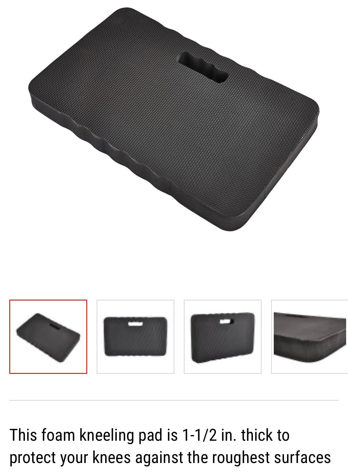

Wait that’s from a knee pad? That looks massive. I was picturing literal pads you strapped to your knees? What is the Witchery?
Looks something like this? About 1.5” think or should I double up?
That’s the right type of product. Stacking or not will depend on exactly how soft or hard the foam is. They come in a range of cushioning, so it’s hard to recommend anything specific unless you get the same exact pad that someone already used.
The ones I bought are only 3/4” thick but yes thats basically the product.

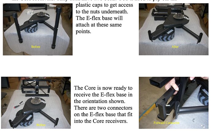

@mcneese.chad no pics on the IR website so asking in case you know… the InsideRide E-Flex page has two different models, one for Kickr and one for the Core. Have you seen both? I’ve listed mine + Kickr 2017 on Craigslist but if no serious offers come in then I’ll just hook up the grocery store bike, like last year, or consider converting to a Core/Volt style trainer if possible. I’ll call IR and ask as well.
Edit: Pulled up the E-Flex Core user manual:
very different attachment methods for Kickr vs Core.
The fact that the E-Flex only rocks when you turn the handlebars seems like a terrible idea that misses the point of rocking motion entirely. That is, you want to bike to move on its on accord somewhat. The name of the game is minimizing pressure points and spikes.

The Inside Ride E-Flex moves / leans as you pedal. It doesn’t take conscious effort to induce the lean like you are implying. At least for me when I had it (prior to the switch to a smart bike) the E-Flex made a massive improvement in ride quality, especially for longer 2 to 3+ hour endurance rides
