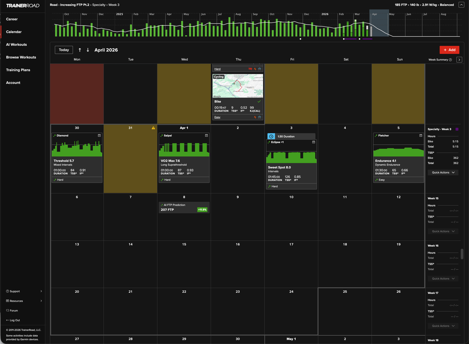

On March 26, I decided to begin recording my commutes to the workouts as separate rides. After doing so, TR via desktop did some hard computing, and after about 10mins of the Prediction working, it gave me a +11.9 ftp bump.
I’m wondering if the Ai is seeing all my past workouts as longer than necessary and lowered my prediction based on the extra stress the commutes were adding to the workouts.

As far as the AI FTP Prediction goes, we’ve identified an issue with how our model projects planned outside workouts. If the entire plan is set up as outside workouts, this affects your predictions more than most.
Our team has a fix ready for this that will go out alongside some broader model improvements, so predictions for outdoor plans should be more accurate from the start going forward.
That said, your prediction is still going up! And it looks like your rating your interval workouts as Hard-Moderate + you’ve definitely noticed increases in speed + endurance!
