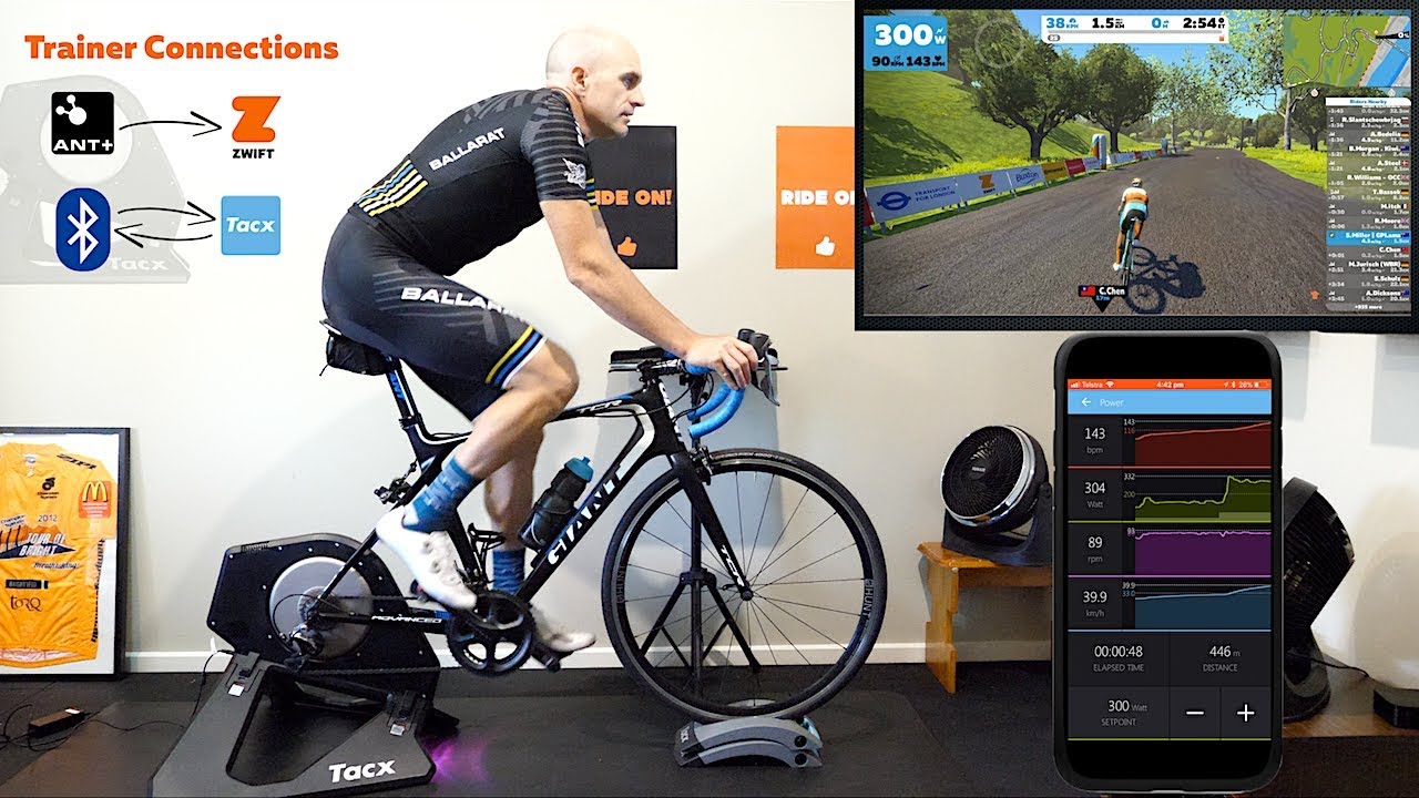

Can this work
You should (hopefully, possibly) be able to get it to work by starting TR first via ANT+ and then starting RGT via BT and their phone link thing. I’m not sure how/if it would work without a trainer/power source that functioned on BT & ANT+ at the same time.
Lama says this also :+1:
I run TR and Zwift on my laptop (with a TV as a second screen).
I needed two ANT+ dongles. I load up Zwift, sync it to my HR strap and powermeter, then load up TR, which then finds HR strap, powermeter and trainer.
Haven’t tried RGT though, but the two dongles is what worked for me.
