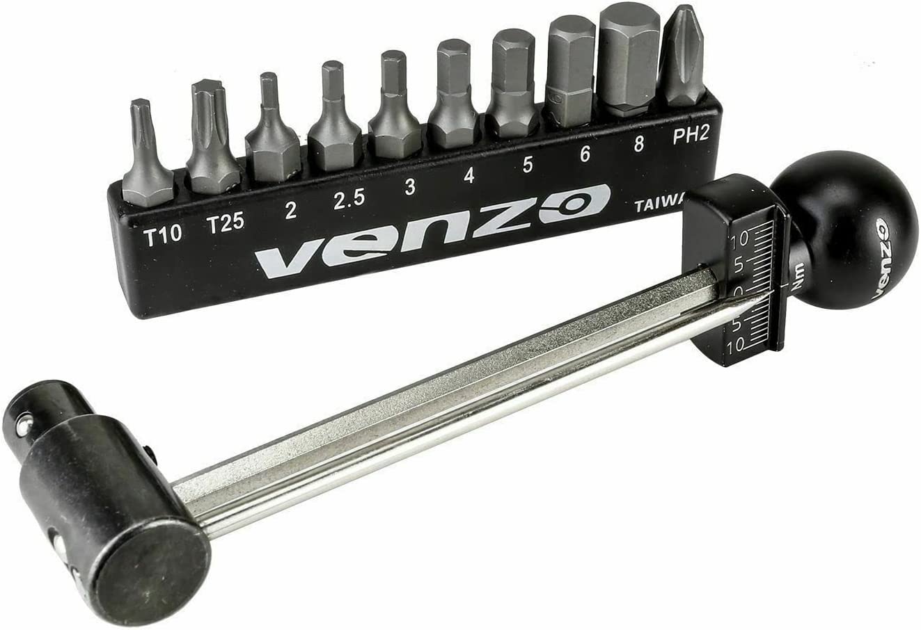

yeah… this is bike tq wrench is a good value/size/accuracy for what you’re trying to do. The beam wrenches are more accurate than the fancier ones. This is smaller than most multitools anyway.
Thx. I ended up getting a park tq wrench w some bits. I’m still not a fan of titanium bolts or the spec design.
