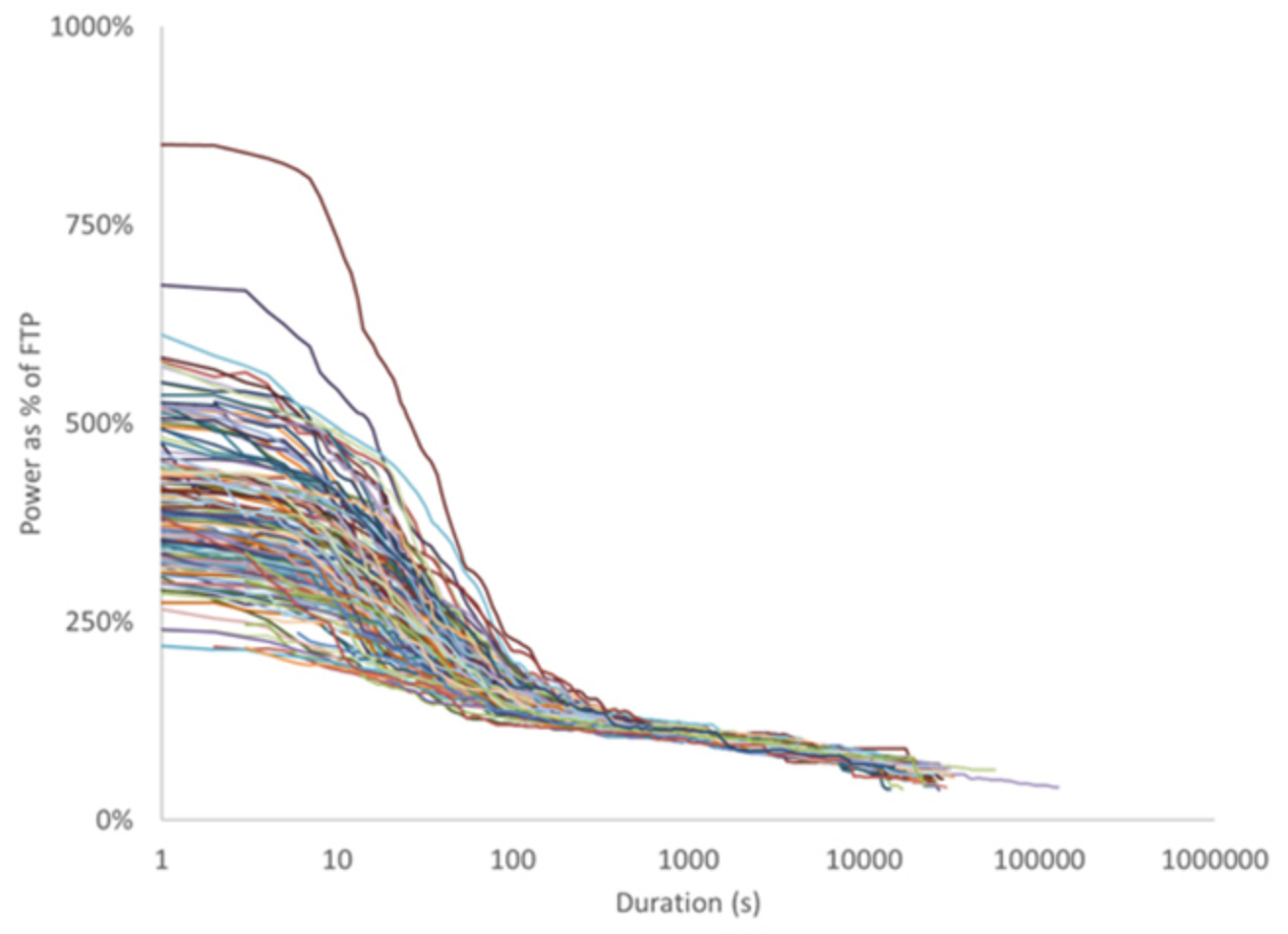

From the guy that came up with FTP and power based training, my understanding is that interval duration at FTP power and below is NOT highly individual:
That chart shows when power is % of FTP, there are small individual differences in how long someone well trained can ride at FTP and below. The big individual difference are clearly seen on interval duration at vo2max power levels and above. It just seems to me that these conversation are freely playing around with terms like “sweet spot” and “tempo” by adding someone’s % HRmax into the conversation.
