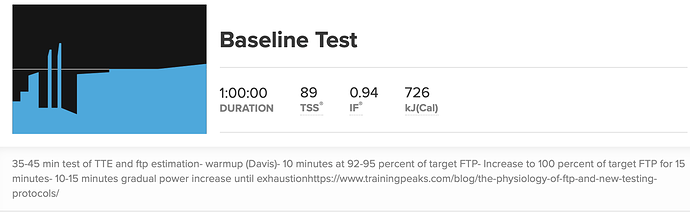

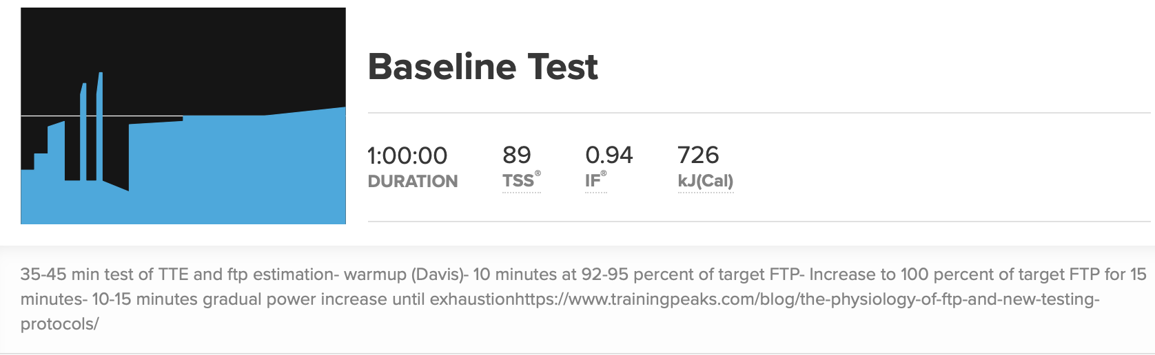

Used WorkoutCreator and started with Davis, a 20-min warmup workout, and added the Baseline test described in the TP article:
My only dilemma - was planning on doing another crit on Saturday morning. Crit or Baseline Test, hmmm…
