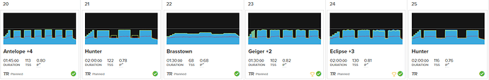

A quick follow up for other people that might face the same conundrum now or later.
Last week was focused on sweet spot and I was able to complete all workouts (I struggled on some but kept in the sweet spot zone):
I am very pleasantly surprised by that. In a single week, I accumulated 5+ hours of indoor sweet spot at a wattage that until two weeks ago I considered my indoor FTP. So that’s a big thumbs up for the Ramp Test vs. British Cycling FTP protocol (30 minutes all out) in that respect: my indoor FTP is a little closer than I thought to my outdoor FTP.
