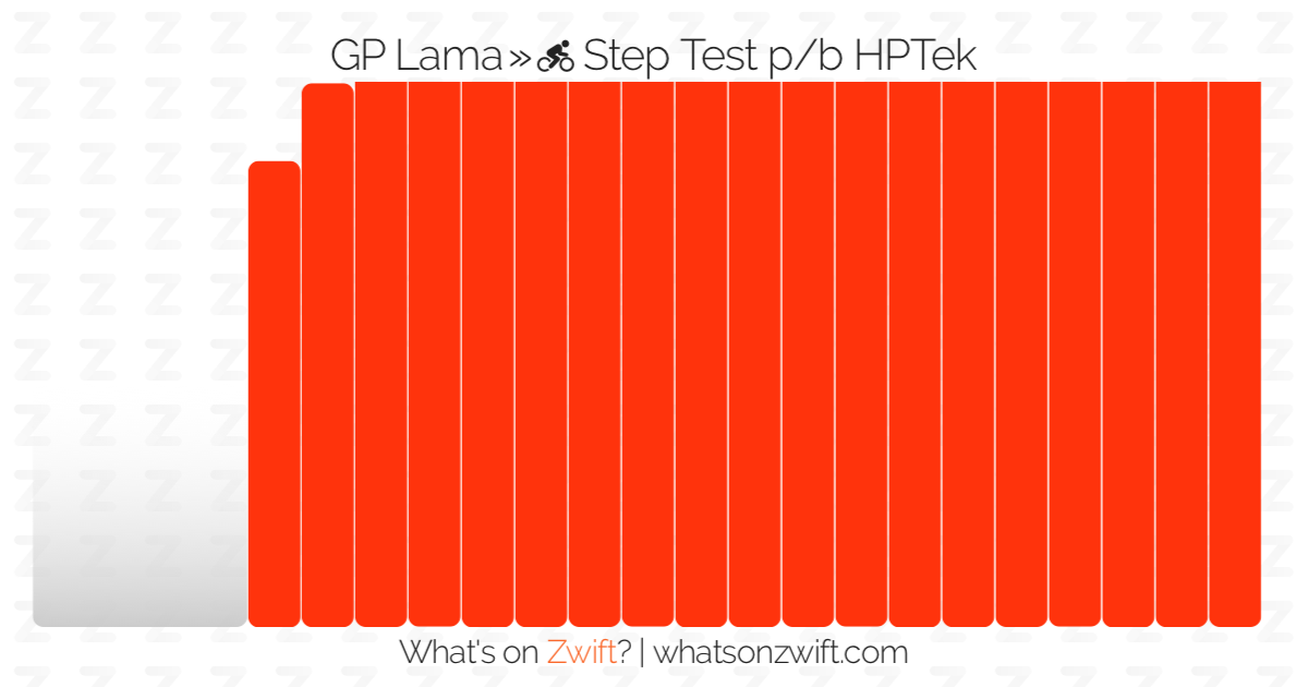

Not to nit pik @P4_Pat but I believe the Noakes test is actually 2.5 minutes with a 25 watt increase at each increment.
Here is a good example of @gpl explaining how the ramp test for Vo2 max (Noakes) is done. How to do a Step Test // Finding your FTP fast with Zwift - YouTube
Thanks for the correction. I’d prefer to be free from nits :smiley:.

and the test is at the bottom of this page:
