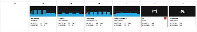

I noticed some annoying pattern in the planning algorithm. For instance, if i have a C-race on sunday, it suggests me a hiit session on saturday.

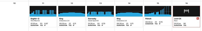

If i define the same race as a B-race, it prescribes me an opener on saturday, which is overall doable (this way i get 3 hard days in a week total, which is manageable).
4 hard days per week would be an absolute overkill for many trained people, so what is the point of these B/C categories? Should i treat a C race as a zone 2 session or what? The description says otherwise (treat it as a hard workout)

I can see how your schedule is somewhat problematic with those two hard efforts back-to-back. I’ll share this with the team to let them know that this can be an issue for some.
Thanks for your feedback and welcome to the forum! :partying_face:
Your own guidelines are opposite of what the training plan is calling for.
it works more or less if a race is scheduled on saturday.
" if possible, you should schedule them in the same manner as which you’d find a really tough workout, i.e., following an easy or off day."
I understand that there may be times where a C race needs to be scheduled on the day before after a hard workout, and we’re aware that this can cause issues that need to be worked around.
Hopefully this will be fixed in the future, but in the meantime, you may just have to plan ahead in those cases.
but how? ditch c race category an use only a/b?
If that’s what works for you. Otherwise, choose a different workout the day before.
We are aware that this can be undesirable in some instances, and the team has taken note, so again, I’m thinking this will be fixed at some point.
Racing on Sunday makes CX a bit tougher to plan out I think. If you were racing on Saturday, I’d take your ‘C’ schedule and put the SS or a longz2 ride on Sunday. Maybe flip flop the threshold and SS day. If this just one week with this type of schedule, sure; if it’s like this every week it could be taxing.
Is the plan builder set up for three hard days? This is a lot of intensity for middle of the cx season IMO if you’re doing this every week. Two hard days with a weekend race with rest being skills/drills and endurance seems to be the norm. I go back to back with my hard days usually. Tues/Weds will be vo2 and threshold, with rest endurance and skills on the cx bike.

For a training race on Sunday I would do the workout, you’re off from training on Monday anyway.
Or do as DMC said and switch up the workouts so the harder one is in Thursday with SS on Saturday, that should open up the legs.
If you find that you’re still feeling it for your Tuesday workout I would change it up with workout alternates or make it an endurance ride.
You may surprise yourself.
IMO this is much too much intensity. But the specifics of how you might want to change it up really depends on the wider picture. Is this toward the beginning, middle, or end of your season? How are you feeling now? etc.
You might not be getting the same training stimulus from a CX race as a true VO2 workout but you’re certainly getting almost all of the fatigue and you can’t just add in the VO2 workout to the week to get that stimulus because then you’re just doubling up on the fatigue.
If this were me, I’d:
  • Drop the OU on the 15th. If you feel you need some openers then add some small efforts to a 90min endurance ride
  • drop at least the second VO2 entirely. You’re getting a decent amount of repeatability stimulus with the CX race
  • Do King or 60min endurance on the 11th
  • Garroby on the 12th
  • 60-90min endurance on the 13th
  • off or short endurance on the 14th
  • keep Parah on the 15th if you’re feeling fresh again
I don’t race CX but I do crits throughout the summer and that’s kinda what my schedule looks like with back to back race weekends. You’re hitting the Z5/6 stuff in the race but you’re missing out on the aerobic aspect of SS/FTP. So you rest a bunch, do some Z3/4, Rest more, open, race.
Now if this is the super beginning of the season and you’re racing till February then maybe you do a touch more intensity but if it’s the middle/end of the season then you’re much more likely to overtrain than over recover at this point. The risk of losing much fitness is pretty low but you can certainly do too much and hurt the back end of the race season.

This is my scenario of this season’s training races, I had four in the series with a week break after two weeks.
I was able to do it but have it been a longer training series I would have been cooked.
What I would have done differently is change Thursday’s Vo2 workout to a SS or Endurance ride to have better legs for the Sunday race.
This is something I’ll do next season using TrainNow to pick the workouts.
If it’s only a few training races and you stick to the plan, I think you’ll be ok.
