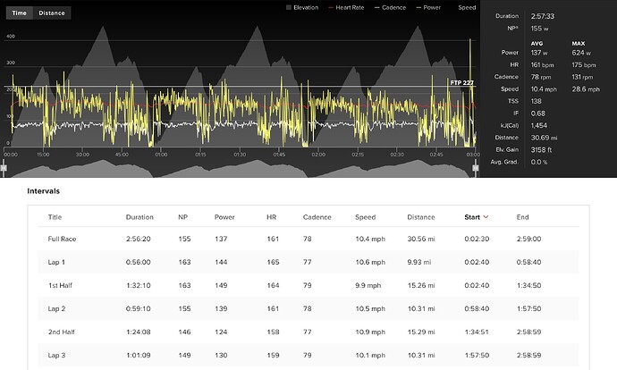

- I planned to pace at under 190 w (84% FTP altitude adjustment) and aim for 0.8 altitude adjusted IF
Here’s the ride at hand:

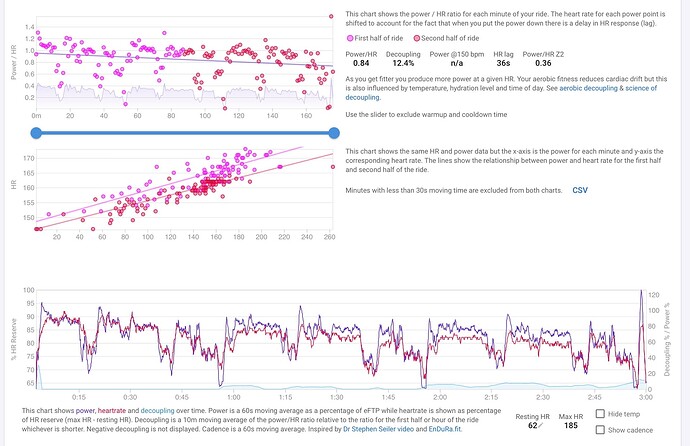

First off, I’m happy with the performance. Nailed the IF and didn’t get altitude sickness. In hindsight, I think I may have left just a little on the table but in the race it felt like I couldn’t push any harder on the climbs.
I’m trying to figure out how I managed to negative split the race while also having a lower NP and lower HR in the second half of the race. My speed over the second half of the race increased from 9.9 mph to 10.4. Maybe I was getting more familiar with the course and carrying more momentum? I’m not sure where I found that speed but I’ll take it.
Interestingly, I also saw my HR drift lower through the race faster than my power decreased. Below is interval.icu charts on this. Is reverse cardiac drift/aerobic decoupling a thing? I was expecting the opposite especially since I’m non-acclimatized. Has anyone else seen this phenomenon? And how can this be explained?
