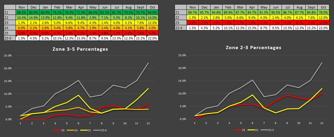

Here’s Ingred Christiansen’s year broken down by time in zone for both the 5 and 3 zone polarized models:
And here is a breakdown of the percentage of overall training time in zones:
Hopefully this makes it a little clearer what’s happening with the percentages and overall time in the higher zones.
(I’ve changed the dark green and light green round as I though Seiler’s way of doing it was counter-intuitive)
