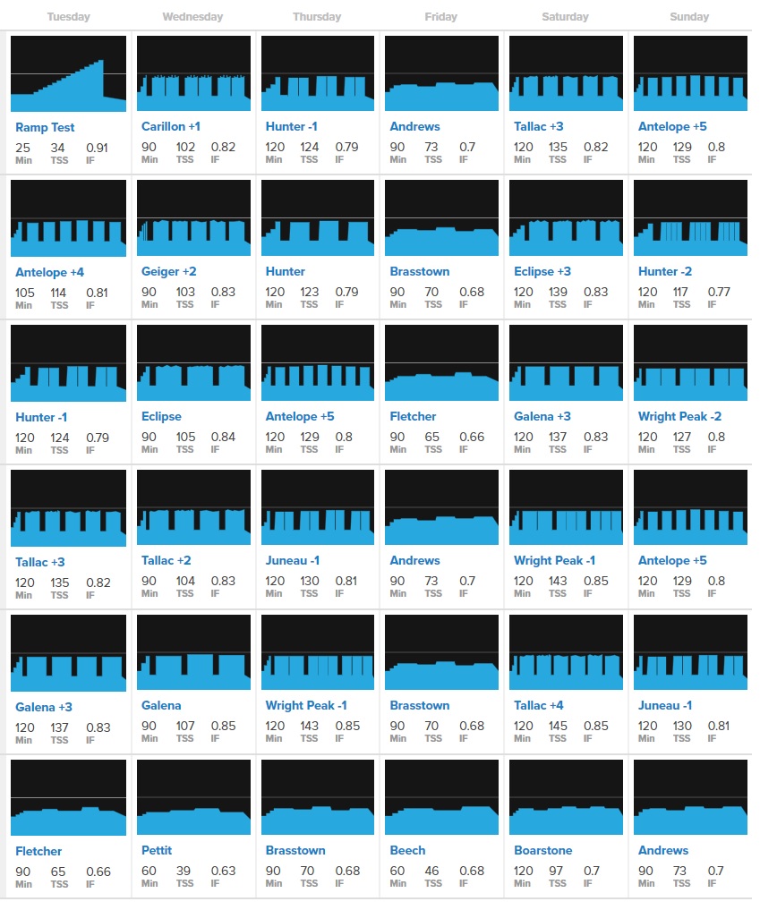

This is a hard sell:

One the one hand, I agree with @themagicspanner, that SSB-HV screen grab above is a hard sell for me. Likewise, I’m not going to piddle around at VT1 all day and then do 8x4mins 105% w/ 2min rest year round either. Of course I’m oversimplifying what both systems propose but that’s just my point. This stuff is nuanced and there’s just as much science (and lack thereof) on what might turn out to be a false dichotomy. There’s clearly conflicts, not the least of which is the sweet spot interval itself, which drives me nuts. But, I guess I still like riding my bike.

I agree with you and @themagicspanner about the screen grab above being a hard sell. Working out a lot of sweet spot daily hurts me…like, I don’t really want to do it. I feel like it works to increase my FTP, but I am tired and grouchy with it.
