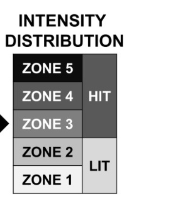

The Road to Gold: Training and Peaking Characteristics in the Year Prior to a Gold Medal Endurance Performance
Eleven elite XC skiers and biathletes
Annual training characteristics.
A: Total training time (h) distributed into endurance training (zones 1–5), strength and sprint (bars, y-axis), and total training frequency (sessions) (line, z-axis) during each month and divided into phases. B: HIT frequency (sessions) distributed into zones 3, 4 and 5 (bars, y-axis) during each month and divided in phases. There was a statistically significant difference (P<.05) in total HIT sessions and zones 3, 4 and 5 respectively across the GP, SP and CP. Pairwise post-hoc tests showed: * Difference in total HIT sessions across phases (P<.01). # Difference between zone 5 sessions vs. GP (P<.01).
Exactly the same as for the eltie Swedish XC Skiers, posted here before. Significant amount of training in Seiler-zone2/5-Zone-model-zone3&4
So during general prep, the xc skiers did < 10% of their total time in zones 3,4,5. And this is for a low impact sport. They don’t approach 20% until late in their training cycle while still being below 15% of their total time at intensity.
