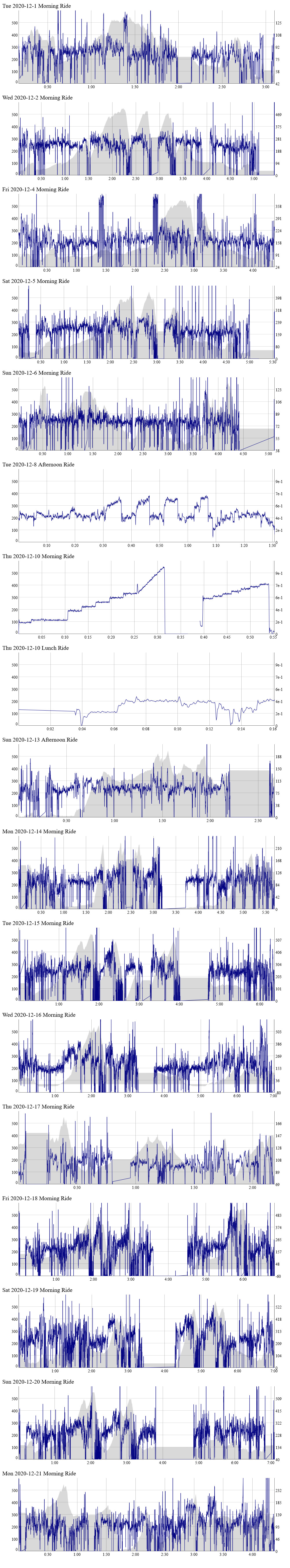

new Bora-H rider Nils Politt. Logging some massive hours on Mallorca this month. Last week were 35hrs … in that week.
grafik
