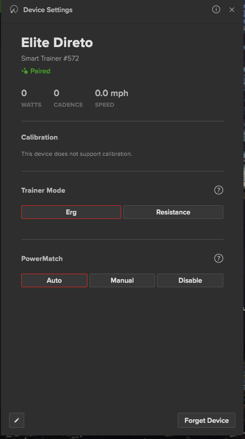

@alhan Thanks so much for replying. Maybe this is another case for support. In answer to your 2 queries: 1) “Cadence Only” is switched off, and has been; 2) Honestly don’t know if the desktop (on iMac) app is up to date. I finally went into the Finder and used Get Info, which gives this as the Version: 2020.16.94. Unlike most apps, the TR app’s pulldown on the top bar does not have an About, and no version number. Hence, the trip to the Finder.
What occurs (about 7 times now) is that the app launches (presumably the version noted above). As it’s launching a pop-up appears (briefly) stating that a new version has been downloaded and will be installed “on next exit” (if I recall correctly). I did catch this time that the new version ends in .97. On the top app bar is “Update Available – App will auto update on next launch”. At far right is an active button to “Restart App Now.” Pressing that causes the app to quit, but it never restarts. There is no version .97 in the Applications folder.
Here is what I see in Devices>Elite Direto:
I think I should be seeing something different if my desktop app has the beta ePowerMatch enabled.

You’re using an old version of the app so should probably contact support to see if they can help troubleshoot why it’s not updating

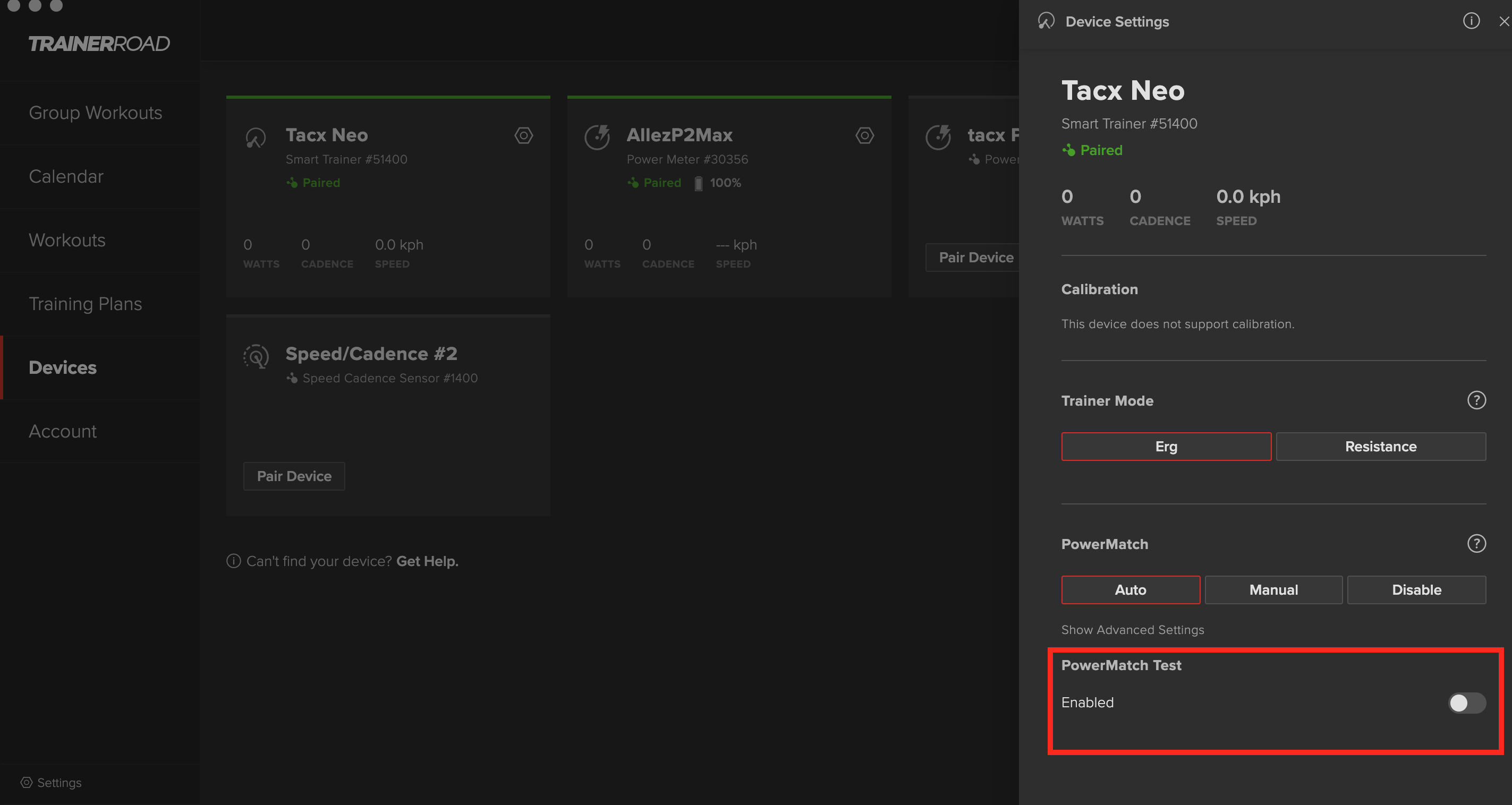

Also, where are you looking for the ePM settings? ePM is not under the TR app “Settings”. You will need to have your trainer paired and then look in its settings to enable and adjust ePM.
In device settings from lh menu, all I have are the erg or resistance options, and if the trainer is on the option to calibrate.
If my cranks are awake I get the power match on/off options but on ePM options.
Yes. The cranks (bike power meter) need to be active/on and paired as well. Otherwise, you will not see the option to enable “PowerMatch Test”
That’s the bit I’m missing, the red box.
I get power match auto/manual/disabled and that’s it (see 2nd screenshot). Which is why I wondered what version people are on.
I’m not using the beta, just the latest stable release. On MacOS also.

Hi @RONDAL, there should be a toggle that says “PowerMatch Test.”
  1. If you wish to take part in the testing of Experimental PowerMatch, please enable it.
  2. Under Advanced Settings, please update “Setting 1” to “0.5”
Original post with instructions: PowerMatch Experiences - #380 by alhan
