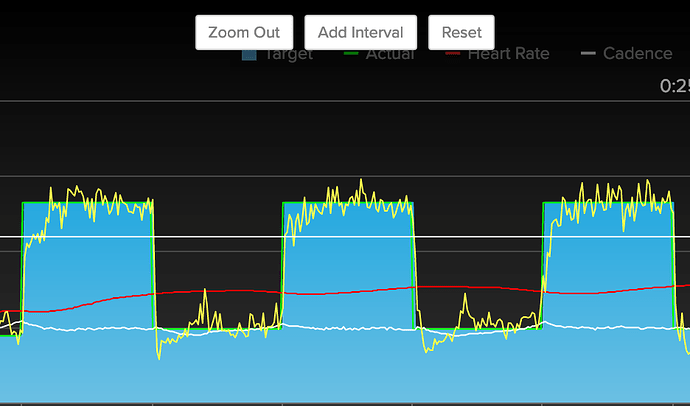

I did this ride - Log In to TrainerRoad - yesterday, and as you can see these intervals, it takes a while for the power to hit the requested level - this was done with “New PowerMatch”. So based on this performance, should I increase Setting 1 from the current 0.5? If so, any recommendations on what I should try?

It is worth a try to increase to 1. If it gets worse, then try 0.1. If that fails, then go back to Legacy and let me know :smile:
I assume you calibrated both devices?
There’s a reason we didn’t put labels on them. :sunglasses: Let’s just say that there’s a lot of math involved.
@alhan,
Yes, I calibrated both. I will give it a try with such large changes to setting 1. But as a former controls engineer, I find the lack of sensitivity to Setting 1 very interesting.
Cheers
From what we can see on our end, it looks like the two devices are not cooperating at all, just before each interval. It’s a timing issue more so than a sensitivity to the target being sent. The difference in timing is creating a massive offset, which PowerMatch isn’t bridging fast enough. We did a simulation and it looks like a lower Responsiveness setting may be the safer choice, but the problem will likely persist.
As you noted, the issue will not be resolved by that setting alone - it seems we might consider a different type of fix for this particular scenario. If you continue to have issues, please get in touch with support and let them know that you are using New PowerMatch. We can try to work through these issues. Meanwhile, Legacy PowerMatch remains available.
