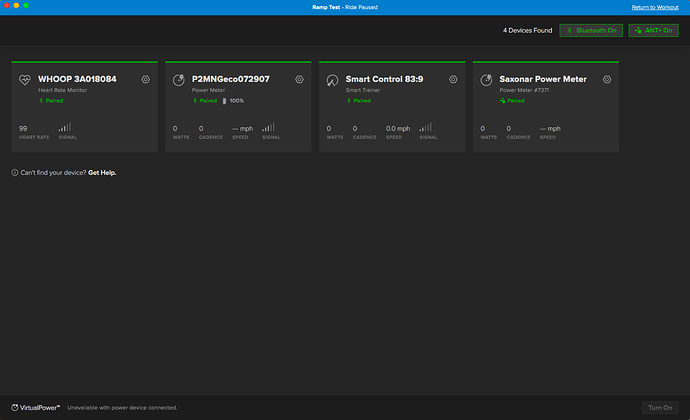

How do we know which power meter’s data is going to be used? I just did the ramp test and it used my trainer’s power instead of my power meter. Is there any way to change sources after the fact? This is incredibly frustrating for those of us with multiple sources.
  • How do you know this?
Normally, TR will pick a power meter over a smart trainer, when 2 devices are paired.
That begs the question, why do you have 2 power meters active and paired?
(Power2Max & Saxonar vs the Kinetic Smart Control)
I don’t think TR can handle that with any reasonably prediction, other than it might prefer the Bluetooth one over the ANT+ (based on their prior comments).
In the web-based analyzer it tells you down at the bottom which device was used.
I was also under the assumption my ANT+ power meter would be used over the trainer’s power but clearly that wasn’t the case today. I only use the Smart Control to determine total distance.
OK, I think an email to support will help here.
