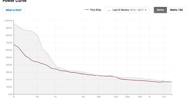

Hi All. First time writer but long time reader.
I have just purchased a LH 4iiii crank and the readings are considerably higher than my Wahoo KICKR. I did a base ride and the Kickr averaged 145W / 1.8wkg (feels about right for the low heart rate), whilst the 4iiii read 210W / 2.7wkg for the same activity. Whilst I read that people are going crazy digging into 5-10% differences, on average I am at at least 30% out. I understand that I can do power match on the Kickr, but matching to such a high watt output does not feel correct. Equally, applying a factor of 0.75x to my 4iiii sensor feels like an extreme adjustment.
I have attached my power readings from an easy morning ride if that is of any use. Both crank and kickr were calibrated before the ride, and then calibrated again an hour in before a short cool down which showed the same deltas.
Do you think the 4iiii crank meter is faulty? Appreciate your advice.

What was the delta between your 4iiii and Core prior to the power match? I feel that 30% difference must mean something is wrong. I know power is not absolute in the world of turbos, but there should be some level of consistency (perhaps < 10%).
30% is indeed a pretty huge discrepancy. My 4iiii left side crank reports about 0.9x what my Core does (and I’ve had four KICKR Cores due to various mechanical failures- all had approximately the same multiplier offset compared to the 4iiii).
DCRainmaker has a pretty good article on this. Don’t expect this to solve your problem, but it does discuss some of the tests to do and how to analyze the data in a little more depth to get to the bottom of it:
Also, a great discussion on these forums about how your KICKR is estimating power (Spindown/energy) vs. your 4iiii (Strain).

I went out this morning and after 10mins or so, the power data ‘felt’ about right. Averaged 174W for an hour or so spin. The power curve overlaid nicely with my best efforts power curve from last 6 weeks on the Kickr (see image). Now I know that the data is still coming out higher as it is compared to my best effort curve and this morning’s ride was relatively easy (despite UK wind and rain!).
Will try and test again against the Kickr this afternoon and report back. Certainly the 60W (1.3/1.4x) deltas should be gone based on these latest data. The first 10mins definitely had very high readings though.
