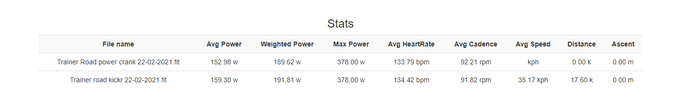

I’m seeing very similar issues as described in this thread now. The only oddity being that when I first got my Kickr Core I ran a ramp test on TR whilst collecting my left sided power data on my Garmin. Popped over to DC’s analyser tool to check it out. As you can see below I was pretty damn happy to see it was well within spec.
1
2

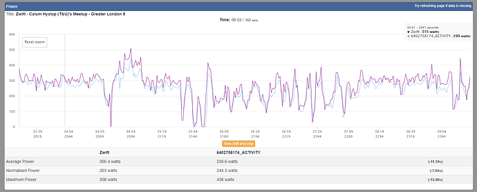

I was seeing good correlation for a week or so but, and this is just a working theory, ever since I performed a spin down via zwift it’s been way off, as you can see below. This is happening on Zwift & TR both in sim and erg mode.
(Sorry @dcrainmaker I ran out tokens for your tool😂 . I would have bought a years sub if I had known the rabbit hole I was going to get into)
Not sure if @gpl or @dcrainmaker can see anything obvious here that maybe I’m missing?
